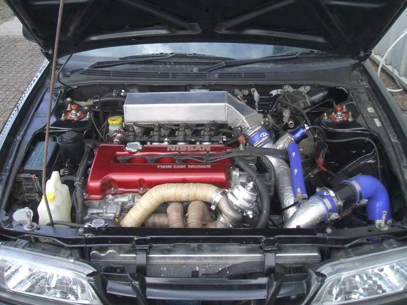

Finshed my engine at last!!!
Dragmera

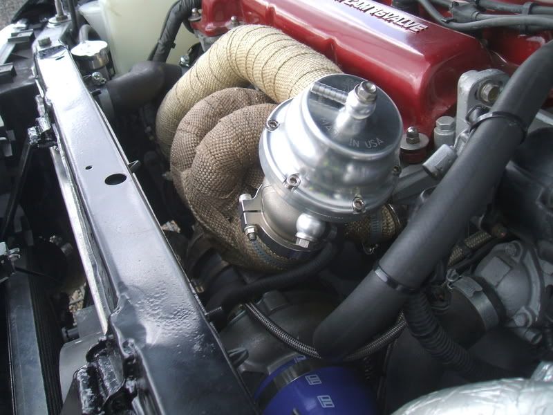

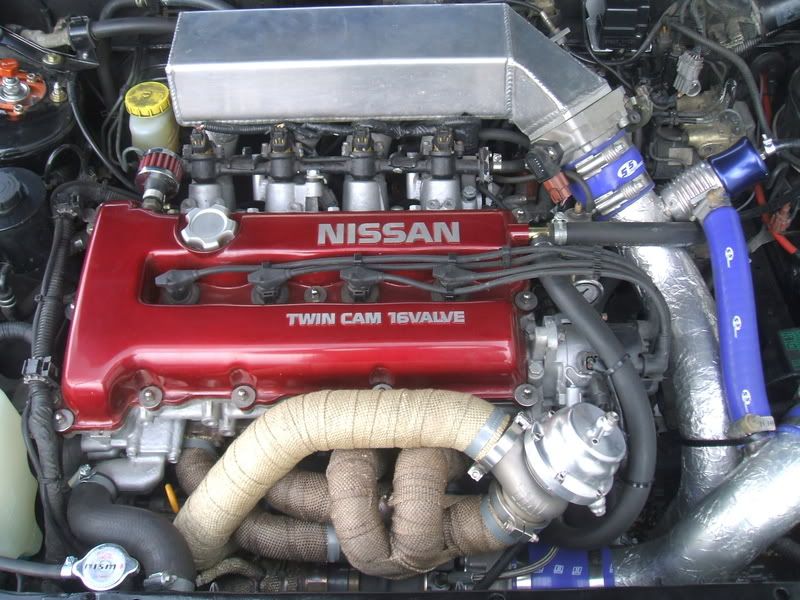

All I can say is thank god it's done...pipework this tight is a pain in the a**e to fabricate.
Dyno. next week.
Let's hope it doesn't break!

Looks fantastic .... a lot of time, work and money has gone into that.
Best of luck getting it mapped and keep us posted!
Rav
excellent work, does look tight in there, makes me want to do something similar with my p10
astarozna

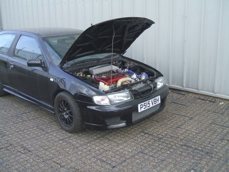

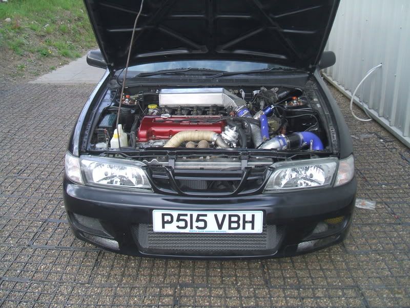

Is that the air filter in the left side of a bumper? I personaly wouldn't recomend such a place for daily drive!
It does look tight, good luck in dyno!
PaulB
Top Stuff Dave.
Is that the engine out of your micra then ? Gonna be running similar power?
I agree with this dude, make sure you don't go through too many puddles!

Yip, with a few changes.
I installed some JE pistons and a bigger intercooler and upped the turbo to a GT30R hybrid, and obviously the external wastegate.
With the lower comp. pistons, I won't have to back the timing off in the top end anymore...thank f**k for that!

Sounds like a good engine there! Should be running some good power. Be hard to put it down onto the road with a FWD car mind.

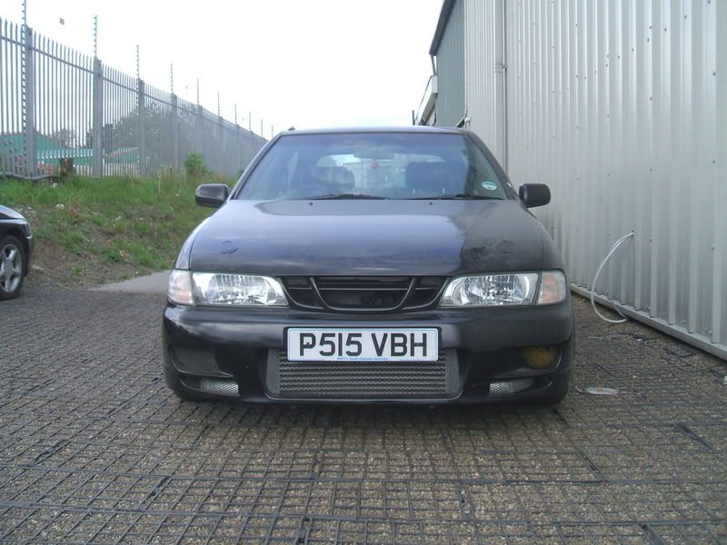

Car is looking good, that the VZE front bumper you put on?
Rayn was telling me that Dougie was buying it off you???

It's just a stock Almera GTi bumper, with a few bits modified to accept the FMIC.
Ryan is right, Dougie is buying the car from me!
Thats a quality sleeper & looks like a lot of hard work has gone into it 8)
Its just a shame it drives the wrong wheels :lol:

Car looks very good, looks a very tight squeeze indeed. Its obvious a lot of hard work, time and money has gone into the development, congrats.
Just as an aside, the Aerocatch's are on the wrong way round :/ the narrow end is to face into the airflow.
