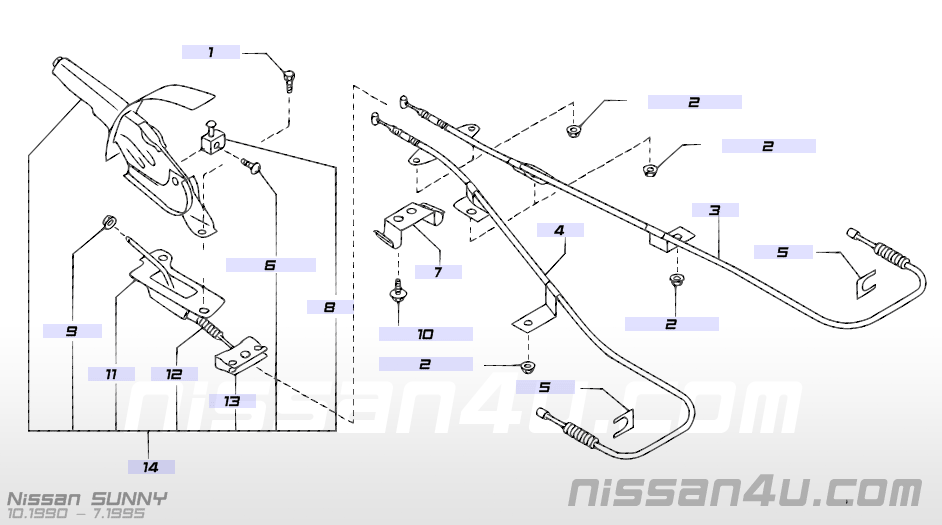

There are supposed to be U-clips? Mine just hook over the mechanism and are held tight by the cable (obviously not so tight they engage the brakes)... or are you talking about that bit further back (which is part of the cable on mine)?
In the foreground:
That's odd, as I said I don't think I've got any U-clips; there's a bolt holding them to the caliper (and the bracket it attached to the cable). That's how it was on the new(er) one I bought from Bob too, so I thought they were all like that. - The rest of it looks the same; is it a Sunny part rather than a Pulsar one?
Here's a picture of the old (spare) handbrake cable off mine:
Where should I have put the U-clip?
