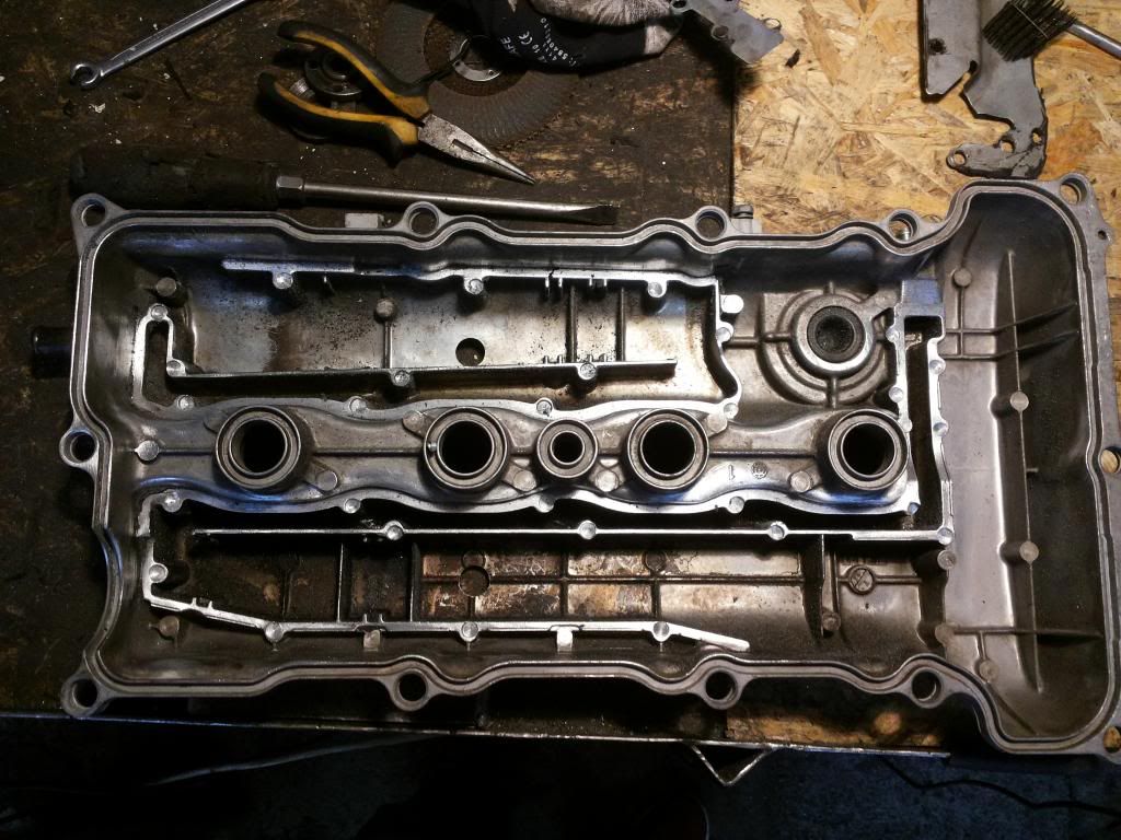

This is how I did it!

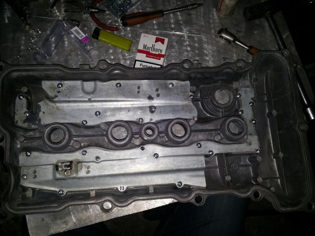

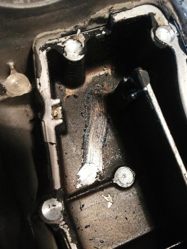

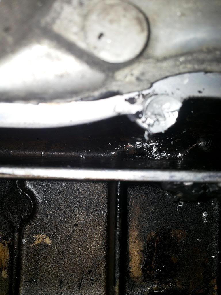

1'st of all you need to drill out the original rivets that hold the baffle plates in place using a 7mm drill.
Enlarge this image
Enlarge this image

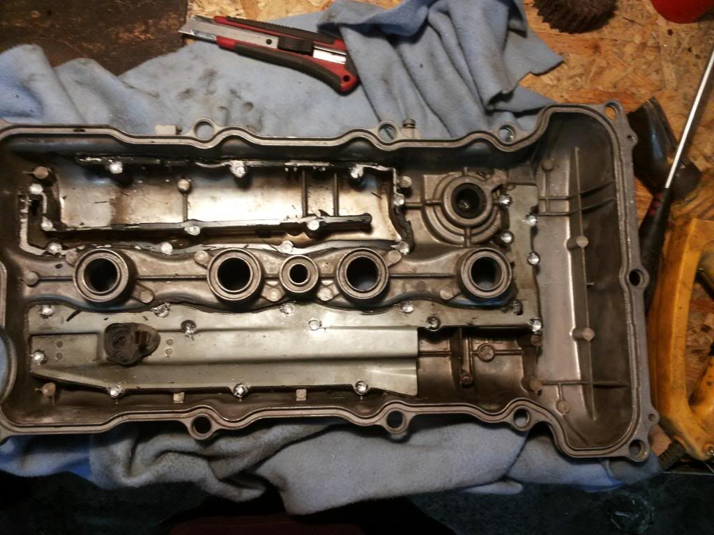

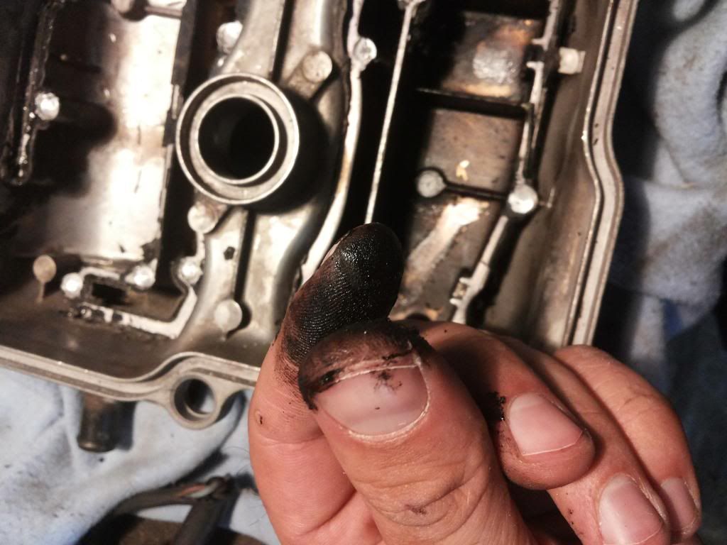

Than....you will discover how much junk that baffle plates are hiding....and all of which is going into your engine
Enlarge this image
Enlarge this image
Enlarge this image

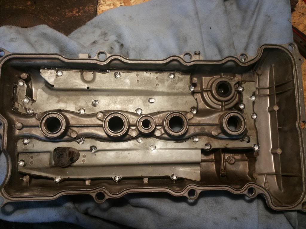

After the drilling of the rivets use a heat gun to ''moisten'' the black silicone.
Than gently .,...with a flat screwdriver take out the baffle plates....if needed slighlty enlarge the holes which you previously did.

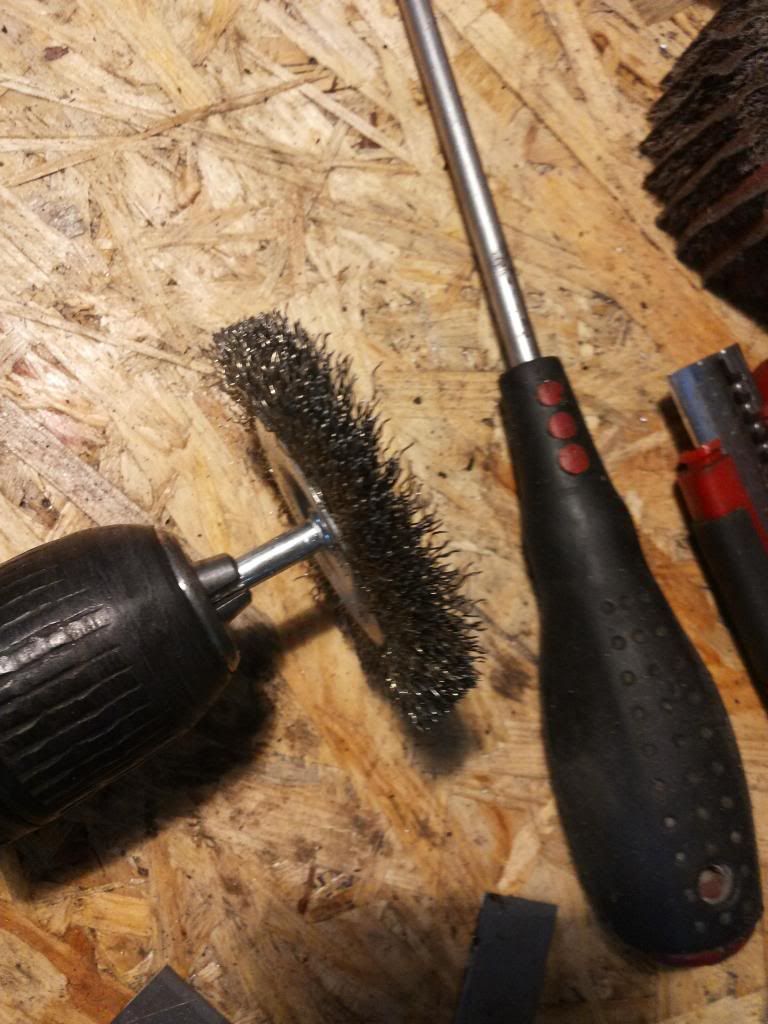

After that use a hand drill with a tool like this one to completly remove the silicone
Enlarge this image

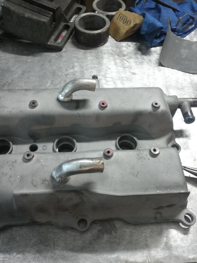

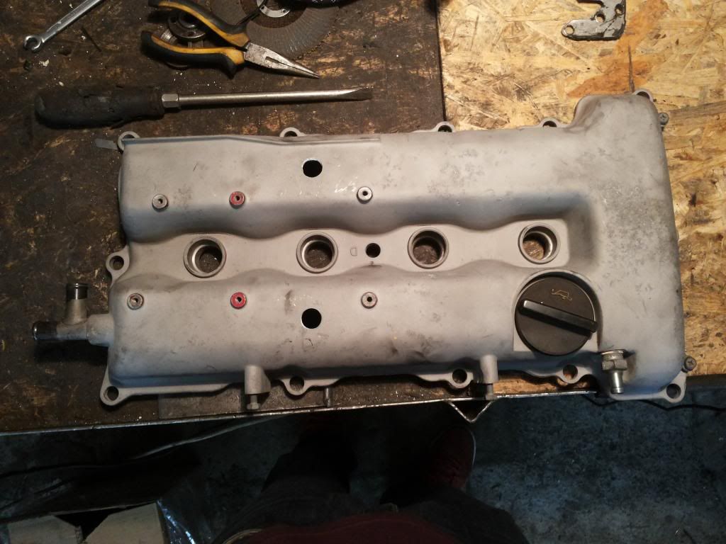

After that you need to find a right place for your new breathers...I have choosen this spots and used a 16 mm drill to make the holes.

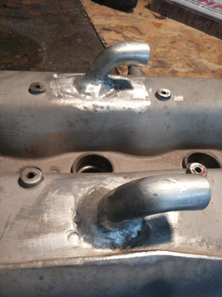

After drilling I have found 2 pieces of 90 deg from some old air con lines.
Enlarge this image
Enlarge this image
Enlarge this image

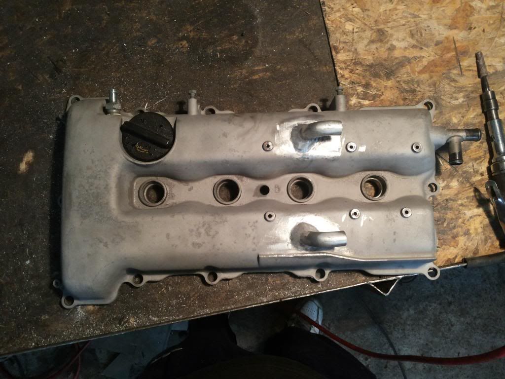

After that I have welded them in place
Enlarge this image
Enlarge this image

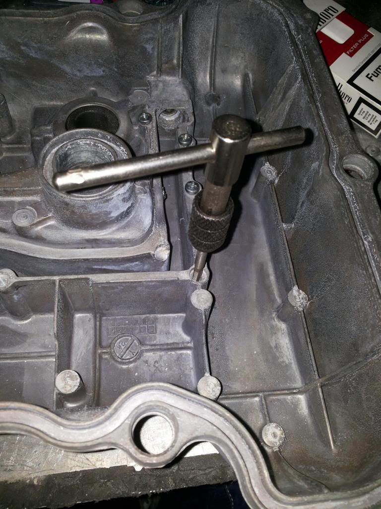

I will be using some 4mm screws......
Where the rivets were.....drill and tap to suit a 4mm screw (or whatever you like) but ensure that you don't drill too much....so that you wil perforate the other side of the rocker cover.

I have had problems with thi sin the past...and thought to add 2 extra breathers on my rocker cover
Enlarge this image
Enlarge this image
Enlarge this image
Enlarge this image
Enlarge this image
Enlarge this image
Enlarge this image
Enlarge this image
Enlarge this image
Enlarge this image
Enlarge this image
