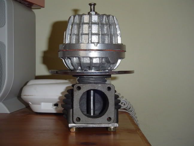

got pic of my wastegate but haven,t finished putting it togeather as yet.

zia i can't believe that you put your wastegate on the table without using some sort of table protection :roll: :D
nice wastegate 8)
