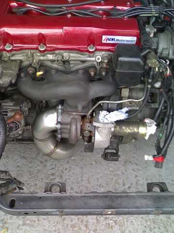

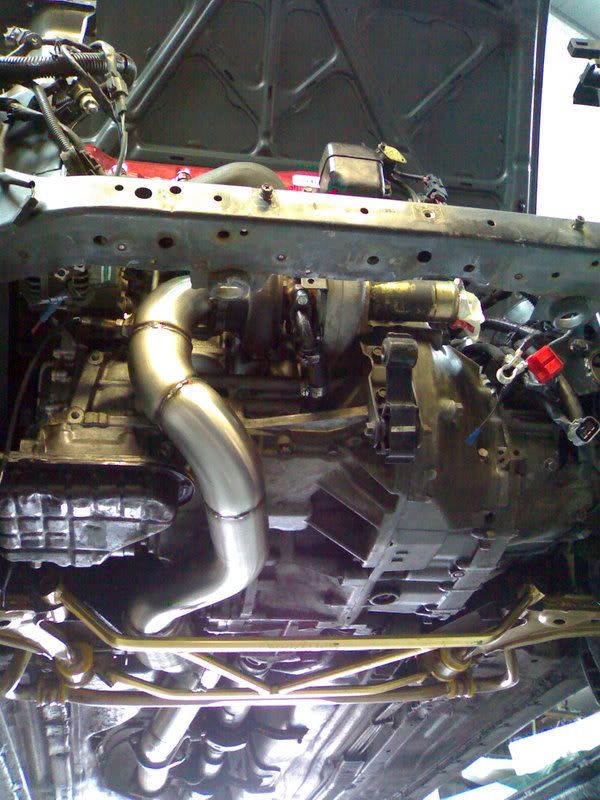

I work in the only decent exhaust fab place on the island, we only stock lengths of pipe and just use a pipe bender but at 3" the amount of crumple you get from the bender you would be better off with a 2.5" mongoos. Have looked into making a full system myself but would have to order up all the mandrel bends and take the time to make it. Would rather buy a bolt on system if I can fine one cheap enough as we only have a mig welder so it would never be very pritty what ever I make lol. Main thing is the elbow and down pipe as I can make the rest with the few mandrels I have and already made a 3" back box. Might give a go at an S14 elbow if i pick one up cheap enough.
Is quite limited to what yo can get or have made over here as most place only stock basic stuff.
The issue with the S14 elbow is that it's not made for an exhaust that goes down and under the engine; it's designed to go back and under the body, so the angles are all wrong. - Like Andy says, you can chop it up and re-weld it, but if you've got the parts on your shelf you might as well chop-up lengths of that and weld them into an elbow.

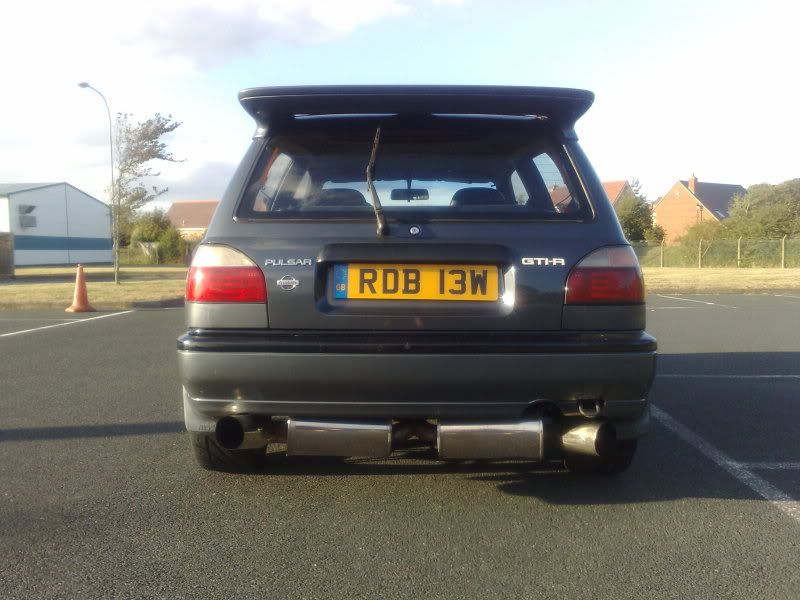

I love the rest of your system but that has be the worst looking backbox ever, it just looks like it belongs on a saxo or something :yuck:
GTI_R
Yes it looks ugly but the pulsar is hardly a thing of beauty ...
Also and the ONLY reason it's fitted is it's SO SO QUIET
