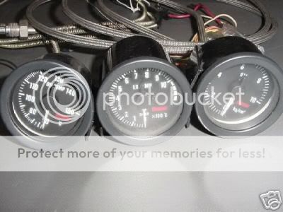

I'm about to buy some used Omori gauges from Japan, Oil pressure, Oil Temp and an EGT gauge, the plan is to replace the standard 3 gauges in the centre console. They seem to be complete with cables and pipes e.t.c.
The sensor for the EGT gauge seems to some sort of screw in type a bit like a o2 sensor . Does anybody know where the EGT sensor should be fitted.

mines in the manifold...ive used them guages ur buying before and didnt find them v.accurate :oops: :oops: v.hard to read off the guage and look very tinny :oops: :(
I'm going to have to disagree with you, I've already got Omori inlet temp and boost gauge these don't look tinny at all and I can read what appears to be accurate readings absolutely fine.
Matt, I don't mean to be funny mate but if you don't have glasses, get some and if you do get new ones.
Bit of a wobbley photo but wtf is wrong with them
