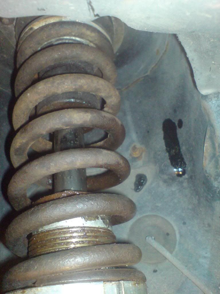

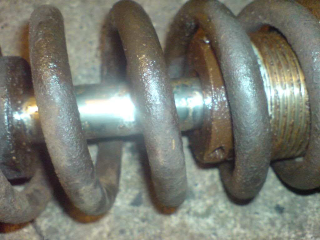

Evening all, some developments:
Took off the shock tonight, done ~1 mile in it since it was fitted. Clearly its leaking to the extent where it is actually going onto the inner wheel arch.
i put a single standard shock back on the front passenger and it gave a noticable improvement.
The front right still was making wierd slurping noises and just did`t seem as stiff/efficient as the standard unit. Put my standard back on and a big improvement again.
pictures below:
Leaking front passenger on the car:
leaking passenger off car:
any opinions? I now got 2 rears that are good and two fronts that are useless.

pulsar craig
looks fooked m8, surely the guy u brought them off knew about it leaking, its not like its just started to go, looks like its been leaking for a while for it to be that bad

thats exactly my point.
This shock (the coilover he had a bump on) is that badly damaged that if you tip it upside down, and lightly compress, then oil runs out.
I bought all four shocks for 270 quid. He`s gave me 70 quid back for the broken shock but i`m still not happy.
I know have 3 shocks, that are not working perfectly, and are that bad that they couldn`t have been ok before when they were on the car.
any opinions?
i understand i was daft buying them looking like they do but i have pm`s and texts saying they are fine, in good working order with no leaks. Within an hour of getting the shocks home i have further texts talking about the leaking claiming to be wd40.
