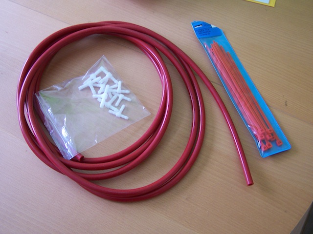

I think he means taking these components:

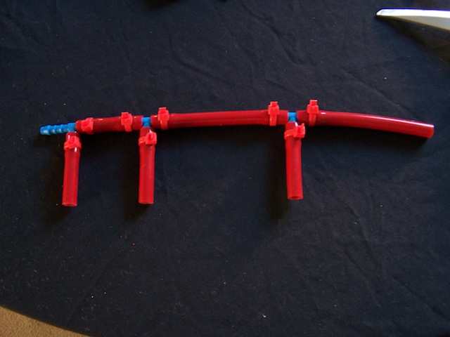

....... and making one of these:

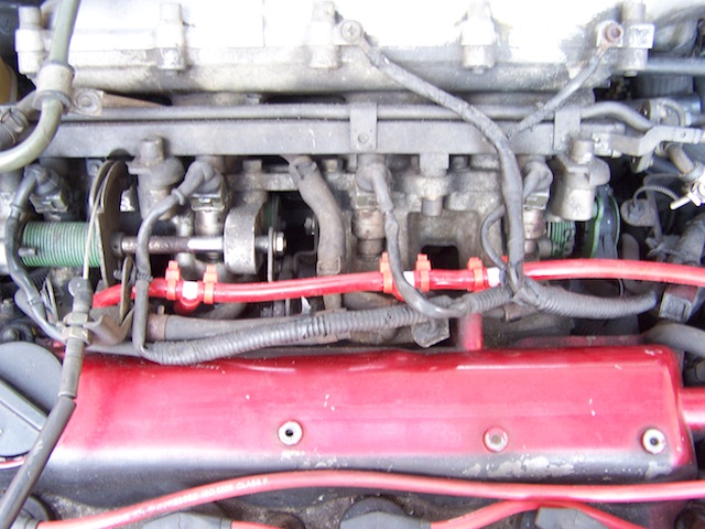

....... before connecting it to the throttle-body area like this:
I never had any issues with mine once the mod was completed. Could it be a knocked sensor as Ed said?
