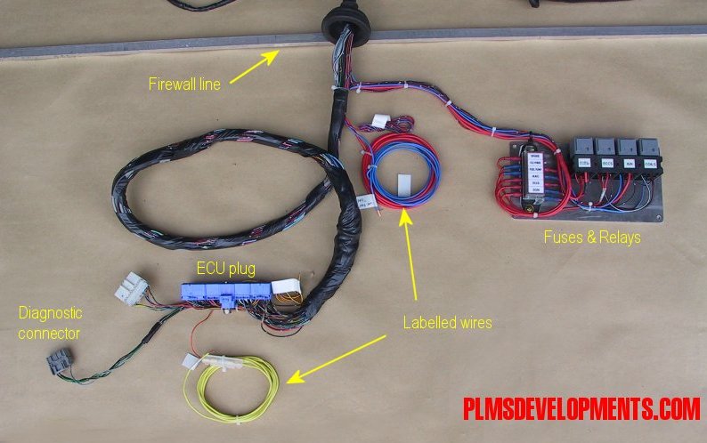

I was hoping to use the origial ECU with Nistune.. Was hoping to make my loom looking like this Datusun 510 SR20DET RWD loom:
What are the "labelled" wires for? That's the cabin side of the loom; you've already go that haven't you?
I still think you need the speed link from the clocks to prevent it for cutting the power on you, but you might be able to turn that off in Nistune... probably not though because it does still have the limits of the standard ECU.
