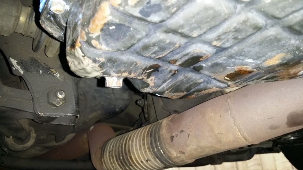

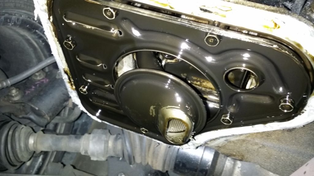

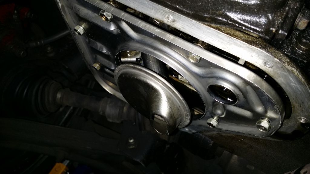

Sump is slightly dented on the front part but when I took it apart it looked like the inside wasn't damaged. I don't know if it would affect the insides or not. Took the pickup hose off and cleaned that too independently and re-gasket gooed it, along with the sump. This was what my mechanic told me to try. Weirdly enough it tractors for over a minute now after cleaning pickup compared to about 10 seconds before cleaning, but car was sitting for a few days prior to clean so maybe another factor?
Before:
After:
(Yes all bolts were done up tightly :) )

Is the pick up sealed properly? ie could it be sucking air in around it and not enough oil at the other end?
Internals don't need to be damaged, the sump being dented closes up the gap between the pick up and the sump blocking access for oil. Quite a few people have cured problems by knocking out a dented sump.

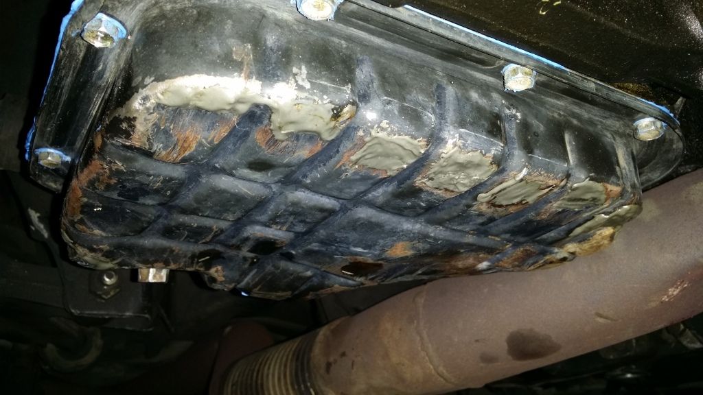

Pictures of engine oil sump as requested. I have already patched it up a bit with cold weld as it had a minor leak, as a might as well whilst changing oil last time.

That sump been hit more times than frank bruno :-S don't know why people don't fit guard over them or full sump plate, I plated mine from front bumper guard & used lower frame brace as back mounting. other trick is don't dump car so low it a road sweeper.
No idea if sump caused issue to start, possible but so is oilpump related fault.
