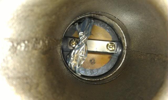

well tonight i've seperated the rubber and solid pipes going to the brake servo and there was a slight vacum but not consistant (car was idling at 2k rpm) and the car was still experiencing the same issues, but at least it rules out the servo and rubber. Next to check the rubber going into the manfold. to make life easier i thought i would remove the top half of the inlet manifold and this also gave me the chance to check the throttle bodies incase the butterfly had jammed open.To my amazement i've found something lodged in the first throttle body, preventing the butterfly from closing. Dont know exactly what it is yet as i haven't removed the blockage, but will do it tomorrow after work and update here but believe i've found the problem. just hope its not broken up into the block and i can remove in one piece

heres an image, i'm normally really careful taking pipes off and any exposed area on the car i block with a cloth to try and prevent this from happening (unless this object was on the cloth when i blocked the inlet manifold/intercooler pipe work.
Do hope it hasn't been pulled through the turbo as mine had no play when i reinstalled it. Aalthough looking at the size of it i doubt it would have gone past the turbine and would have got tangled up
