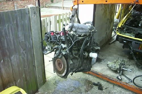

What is the best way to strap the engine (to an engine hoist) for removal. Does it have any eyelets or place to put them in ?

The gtir engine is a right pain to drop because it has no lifting eyes, I tend to just put rope around it and use a bit of trial and error to get the weight distribution right, My other method is to just drop it on my big trolley jack.

The points i use are the left hand edge of the manifold, the dump pipe section on the plenium and both gear box mounts.

its aluminium ;)
round the plenum inlet and the alternator bracket is how i do them (take the water outlet from the head off)

If i didn't see that engine in mid air holding from the inlet plenum , i would have never believed it was strong enough.
Would that suffic for removing engine comlete with Gbox and transfer.

If your removing it with transferbox and gearbox attached then it will have to come out from underneath the car.

i drop them on the trolley like that with the everything attached, drag it out, get the transmission off and your good to go.
i have in the past dropped an engine without using a hoist!
just put a trolley jack under ally sump with a piece of ply on top.
undo all necessary bits.
put another trolley jack under front centre of car, with a wood fence post spanning chassis, near antiroll bar, and jack car right up.
drop the jack slowly under engine, so its down to its full extent, and pull the whole lot out from underneath, on the trolley jack.
can be put back the same way too, if you havent got a engine hoist.
this way you havent got to chain or rope anything up, just let the two jacks do the work.
if you havent got any jacks, then use a couple of freds:lol:

This is how I've done mine the last two times bob, Only difference being I had it up in the air already and just dropped it down on the jack.
Like you say it can go back in the same way ;-)
