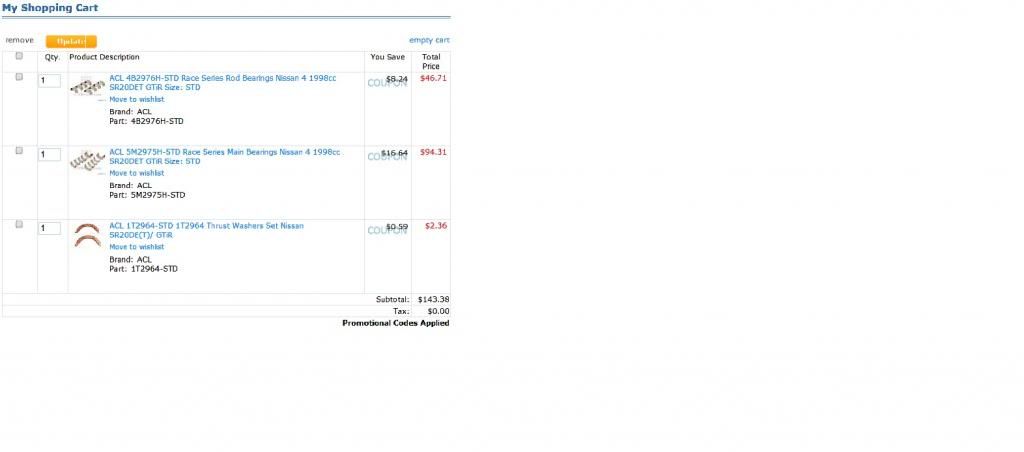

RO_SUNNY
.....Now I have spoken to the guys at FR Sport and they gave me also an Easter discount.
The price shipped to Romania will be 136 GBP....which is cheap.
The machinist inspected and verified the crank and told that is like new and spot on.
He told me that he will give the crank a really soft polish.
Therefore please advice if these ACL Bearings will suit my needs.
Please note that these are the prices without shipping.
These are the H type bearings

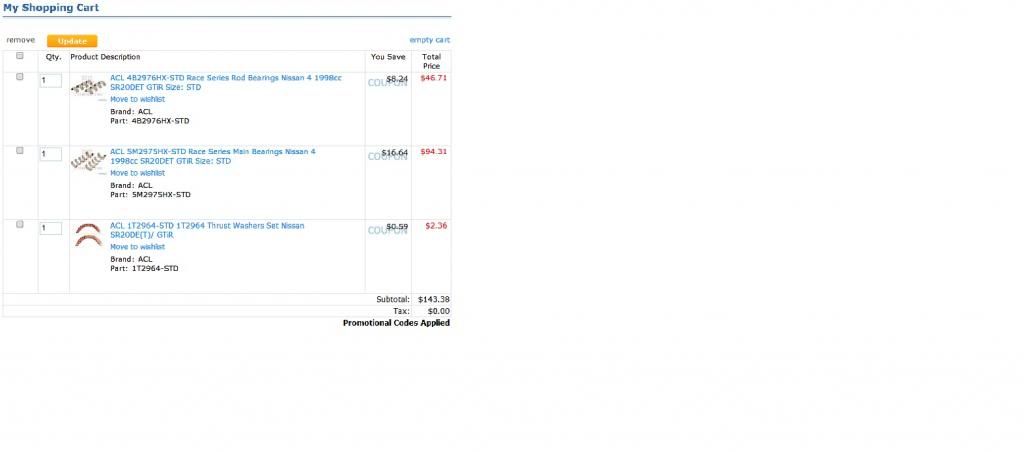

These are the HX type bearings
They don't have the Calico coated bearings.

RO_SUNNY
Cheers Danny!
And thanks again for your help!
I allready ordered them from FR Sport in the USA....
They were approx. 140 GBP with shipping included! Brilliant isn't it?
