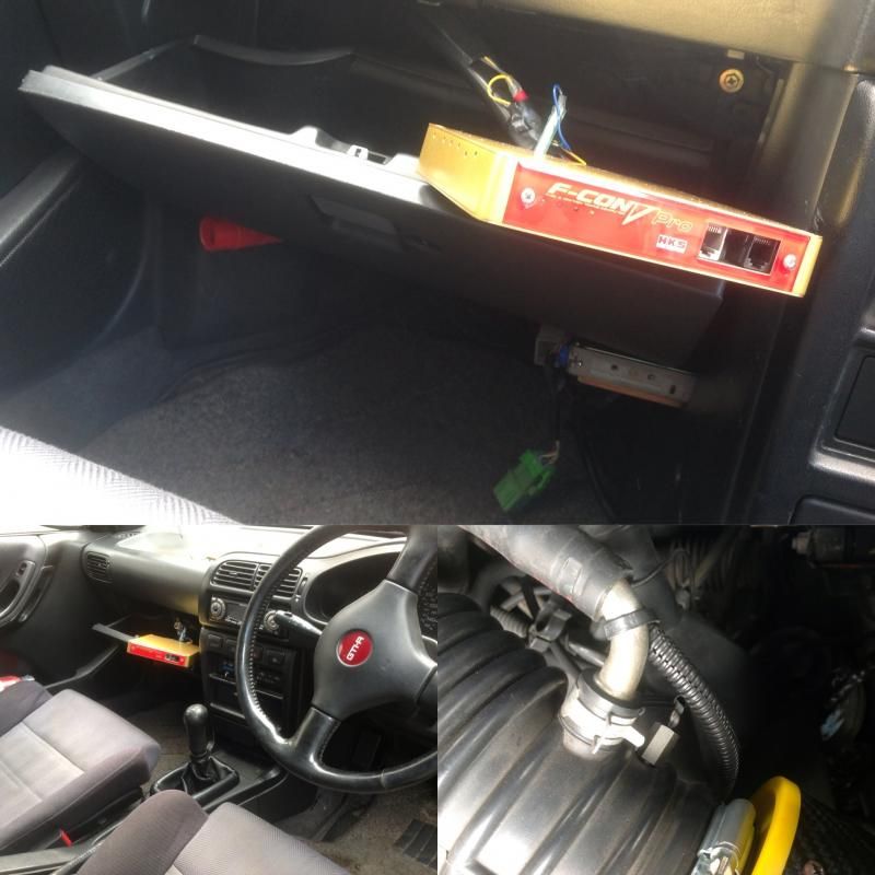

I am running Hks F con pro v gold 3.2 version.
Expensive but has many features, has been mapped very well, and drives amazing, never had a running fault with the car in 2 years since being fitted and mapped. Runs map sensors too. Will work well with my Sr20vet and can use the ecu in other sr20 related cars.
Some may say it's old software, but big power skylines, surpass have been using it for years in Japan and worldwide, and still do.
Also the software is updated to stay with the times.
I am running version 3.2, but 3.3/3.4 is out.
It keeps the standard ecu, so putting car back to standard and keeping the hks unit for another car is posdible.
