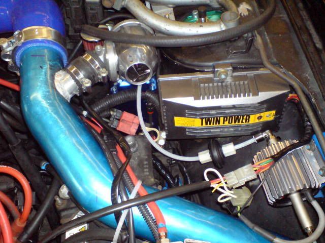

i have a nice front mounted intercooler with all the hard pipes fitted to my R, but i would like to mount my hks ssq to the hard pipe so the air flows into my hard pipe and into my d/v at the same time, how is this done?:der:

The flanges for the SSQV come in aluminum and cast iron, if you have a stainless steel IC pipe run you will be best off buying an iron one (cos you can’t weld ali to s steel) and find someone who’s confident in tig welding differential metals, easy job for someone with the right kit and skills.
you can get the flanges from here
the one listed as steel is the machined cast iron on you'll need.

MORF114 said:
like this?
Yeah thats the one.
