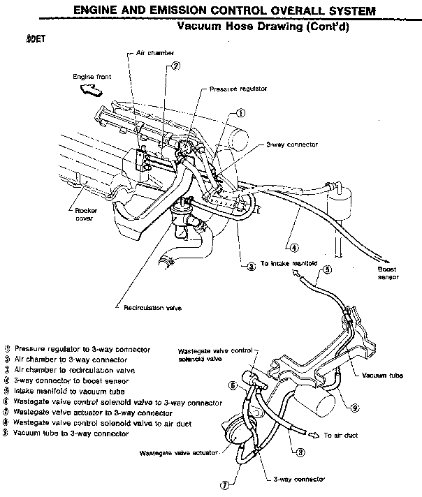

I have fitted dump valves before to old skool turbo motors etc but have never fitted one to a pulsar before, I would normally tap in to the pipe going to the inlet manifold from the intercooler if i was installing one but have looked at my pulsar and now im not sure where would be the best place to install it?
I notice there is some type of original equipment valve under the top mount intercooler with pipes going to the inlet and air filter pipe work is it a standard non atmosphere valve?
im thinking about putting a dump valve or bov on but just gathering info first on where to install it and what fitting kit I need etc
