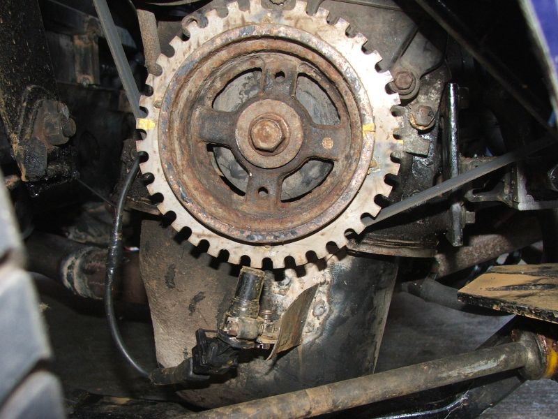

aha thats why there is a toothed pulley on the crank, i did'nt even think about why it was there, just noticed it today

to dark to be going out there now, how does this work then the trigger and toothed wheel ?
sorry for the questions but really intrested on how these work and getting the power it should be putting out,
totally different to my other pulsar that i have
edIt: when i say how does it work i mean how could it be knackered/causing problems
the sensor that is reading of the toothed wheel (they normally sense a missing tooth) could be breaking down/very dirty/loose or the wiring could be knackered

in short, simple terms
there will be a toothed wheel on the crank pulley, it will have a certain pattern, for arguments sake 36-1, but there are other patterns. The sensor 'counts' the teeth and the ecu knows its at tdc on number 1 when it it counts the missing tooth
as soon as the engine turns on the starter and the ecu counts the teeth it will see an rpm.
When i did the clutch on the car with the dta we bent the trigger wheel slightly when taking the engine out or putting it back in and the ecu would lose its rpm reading slightly and not fire properly, it took fooking ages to spot the bent trigger wheel as from the top it looked ok..lol

righto i'l have a check in the morning, i was'nt sure how they worked, being so low down i imagine theres a bloody good chance its filthy
