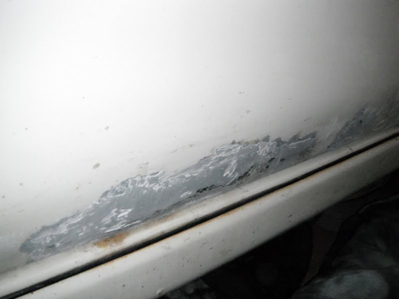

The passenger-side door has been on the way out for a while; this if what it looked like the last time I tried to fix it:
The rust has taken a pretty good chunk out of the middle of the bottom of the door. - It looked OK for a while, but it's starting to come back through now (which suggests I'm getting water inside the door?).

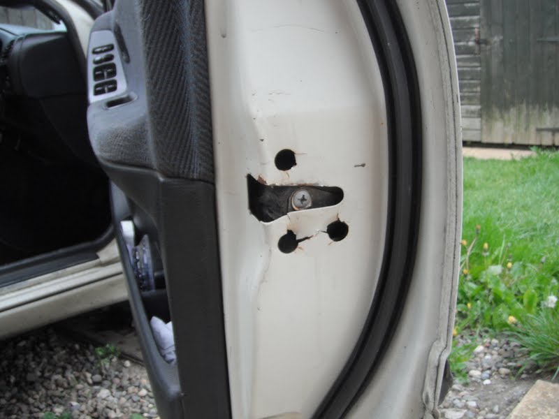

The straw that broke the proverbial camel's back was this:
I went to close the driver's door and it wouldn't catch... because the mechanism has pulled through the steel. - That's repaired with some washers, so not such a priority.
I know there are a couple of people who had doors, but I never followed it up because changing doors seemed like a huge job (especially as it means taking all the mechanisms, speakers, locks, etc out).
