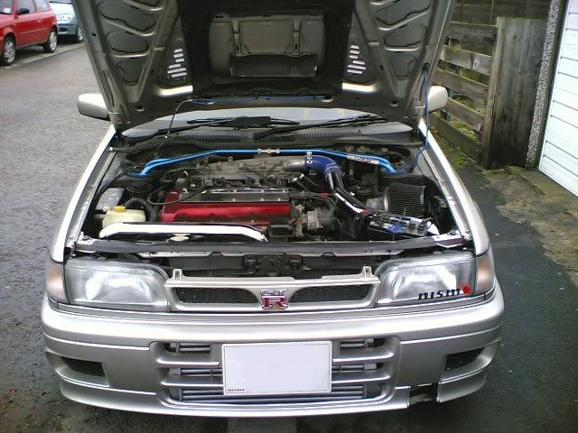

Im not sure if it applys to all front mounts but with the Hybrid you do still have to cut the bumper slightly for it to clear the cooler (mainly at the bottom).
There are only really 2 bars left in front which i doubt will make much difference and i intend to move the number plate for track days :wink:

If you do leave the front in be sure to trim the fla ps underneath where the brake ducts normally sit as i spent half an hour wondering why it wouldnt clear and then found they were catching on the pipework (passenger side) :oops:

:shock: 8) That looks sweet jon , just what im after doing :wink:
You say there is only two bars left but there is only 2 bars to start with , have i misunderstud you??

Yeah you leave them on mate! Its mainly the bottom ducting which guides the air up over and the little vertical fins between the big bars and the fla ps beneath the brake ducting.
