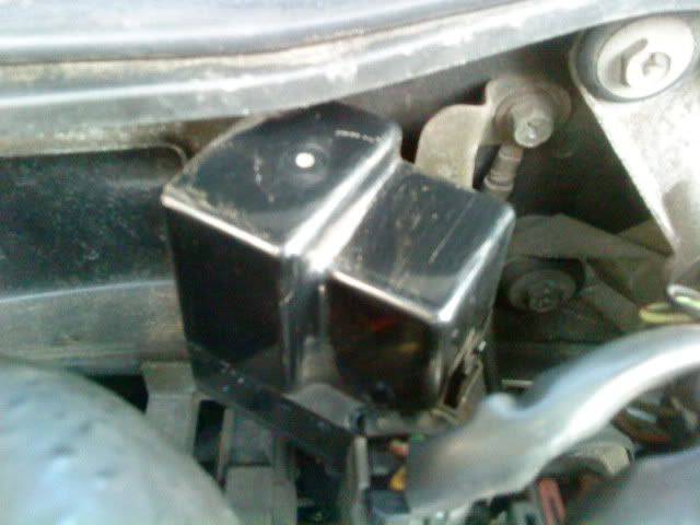

When I turn ignition on I can usually hear the fp priming but instead get a clicking noise so tried relays they're all fine inner fuses all gravy
So took the fuel pump out had a look connected back up outside fuel tank and nothing so got V to bring me his old stock one tried that nothing and still that damn little couple of clicks from engine bay

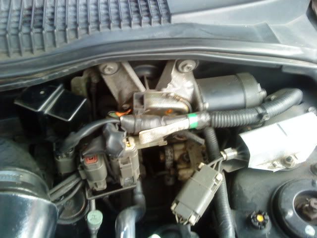

So I had V turn the ignition on and I listened to where it was coming from and I found it a black box just above the fuel filter WTF

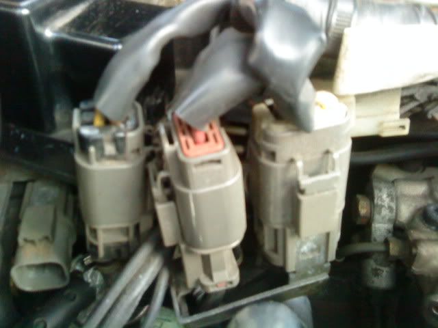

Anyway here is some pics of the clicking black box any ideas would be greatly appreciated

ABS relays you say why would that stop my fuel pump from working then as all other relays are fine I really haven't got a clue?
