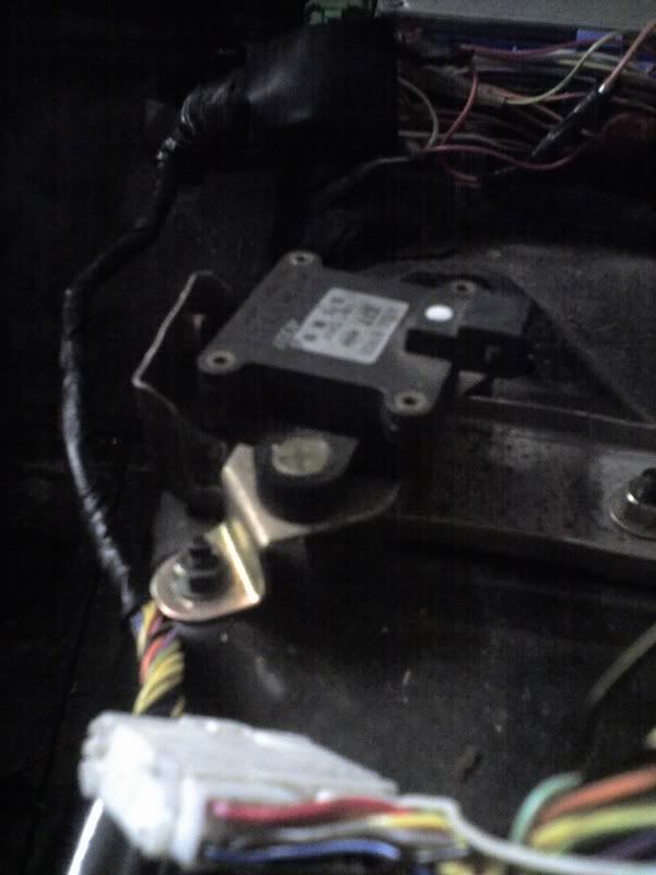

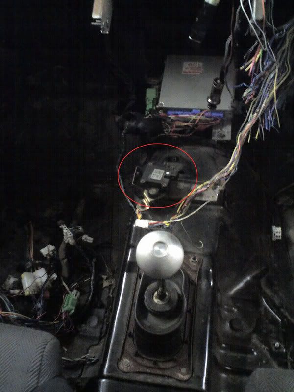

Does anyone know what this is ?
Trip
As the title says, I am putting the R on a diet by removing all the cables/harness i don't need. Is it safe to remove it ??
Thanks

Is that the often talked about g sensor from the abs.
99% certainty that thats what it is just can not see the electrical connector.

"G-sensor for ABS"? I thought ABS just works on the rate of retardation of the brake discs relative to the sensor?!
Has that item got a part number on it? Someone might be able to match it up to a parts list somewhere if you can let us know what it says.

It's in the manual volume 2 page BR-82 4wd models g sensor .
part no 47930 deceleration sensor thats all i could get out of my fast system :).

Bet it goes mental if you get air going over a humpback bridge! :)
