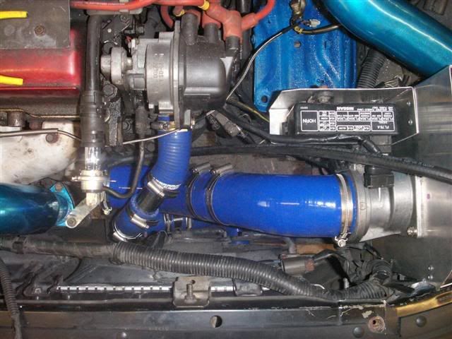

MINESGTIR
AIR CON LONG GONE. HOPE IT MAKES SENSE.. MASSIVE DIFFERENCE ON PERFORMANCE !. IT ONLY DRAWS COLD AIR FROM OUTSIDE VIA THE BRAKE DUCT. ITS IMPOSSIBLE TO GET ANYTHING BUT COLD AIR IN IT NOW !!

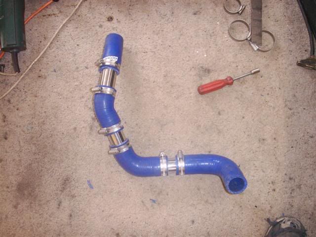

What size pipping did you use for that custom rad hose?

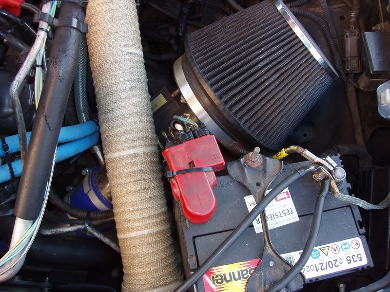

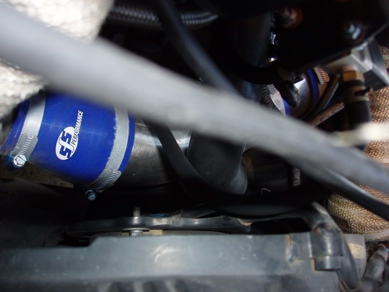

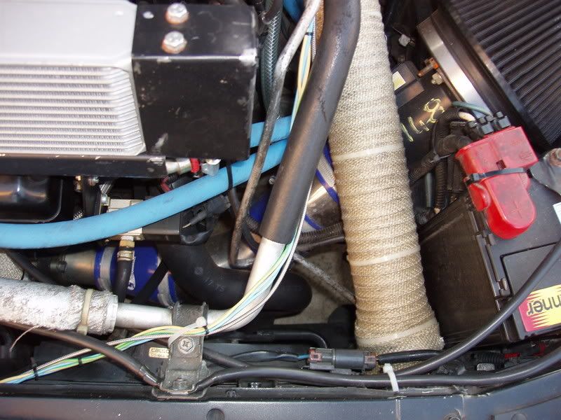

andygtir
yep, and with a front mount ic pipe coming under the headlight. it fits with no problem and keeps the air filter in the standard place.

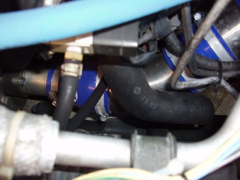

Did you modify the aircon pipe run in anyway?
That's what I want to do but the battery will be in the boot and no FMIC yet...
Is that the stock rad hose, or was it modified?
thx!
andygtir
nope, air con and rad hose all left as standard. i did have to shave a tiny bit off the top of the gearbox mount as squeezing the inlet between it and the ic pipe was a little too close.
