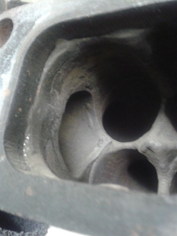

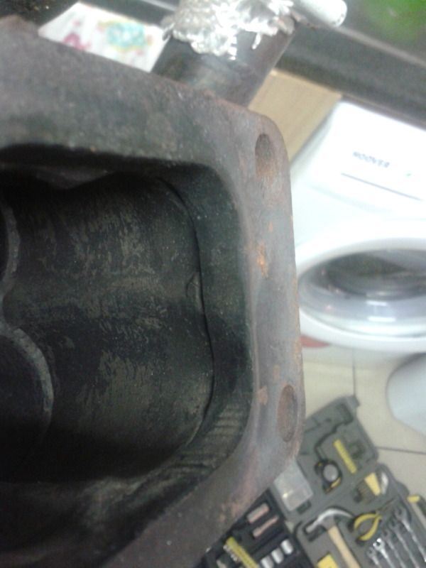

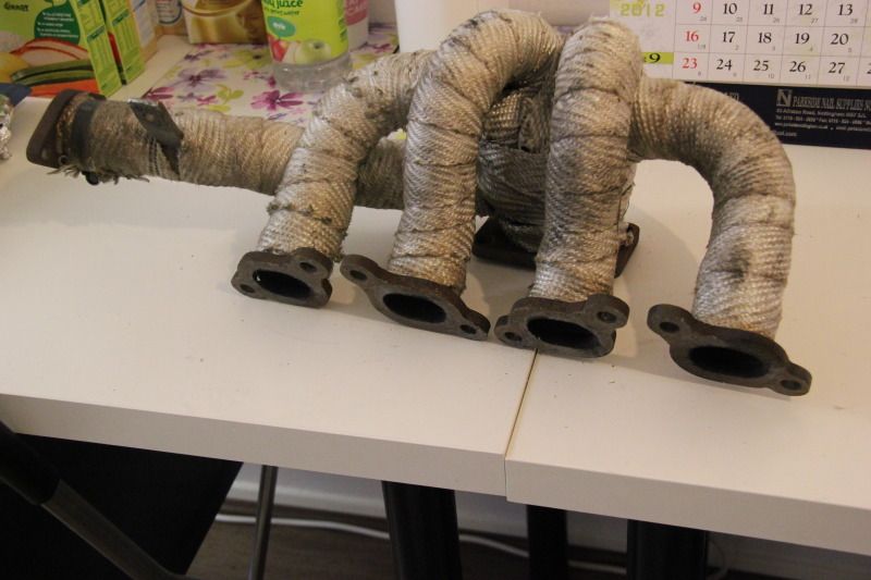

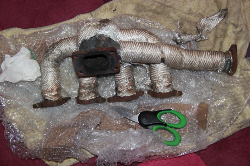

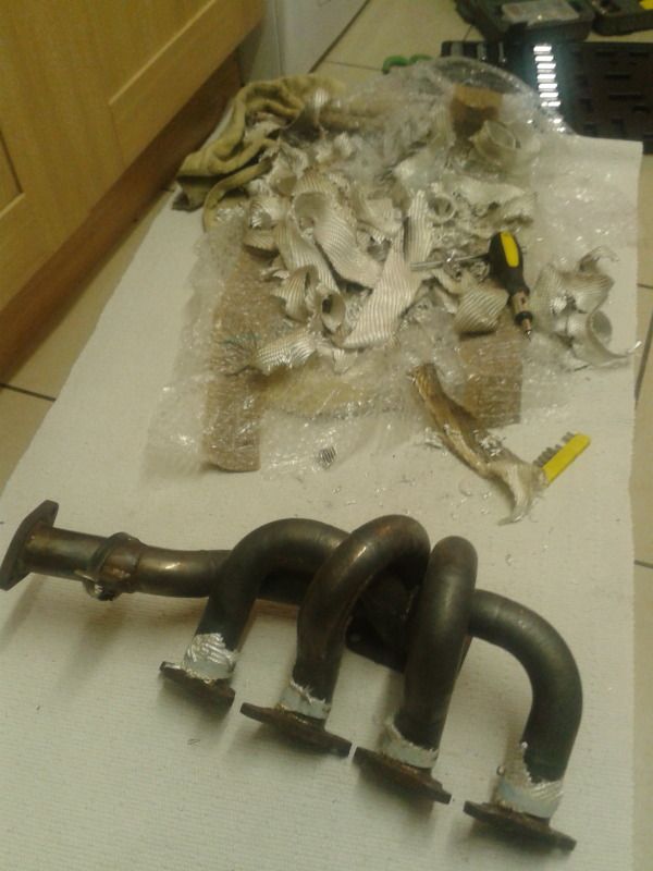

Anyway, I was sold this DP mainfold along with others parts.

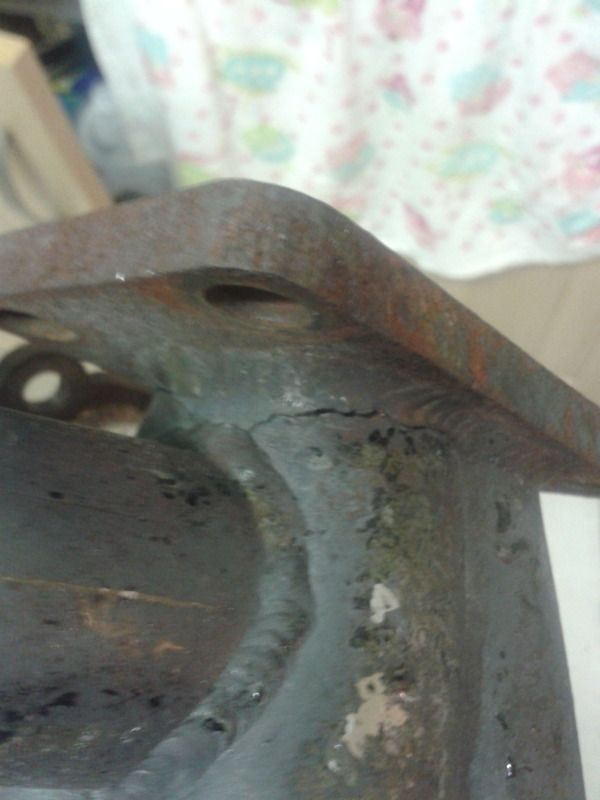

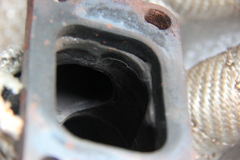

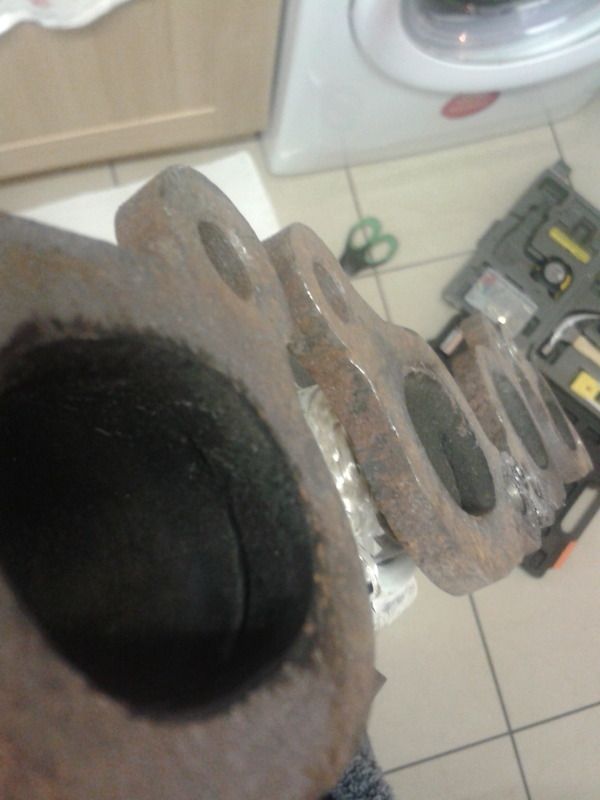

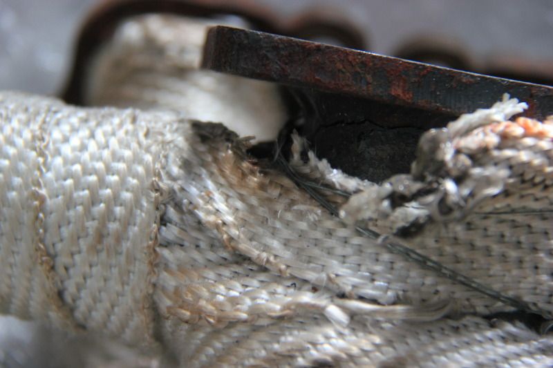

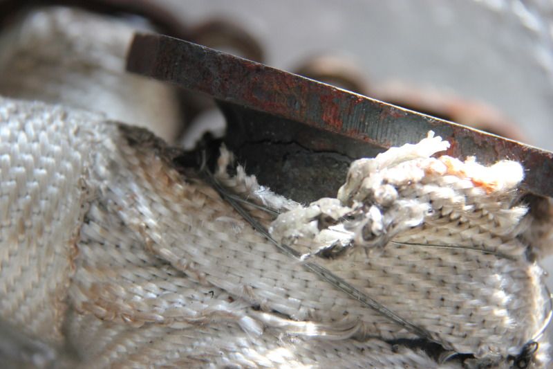

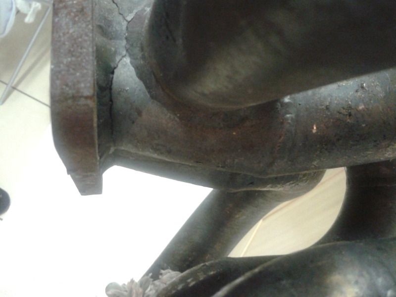

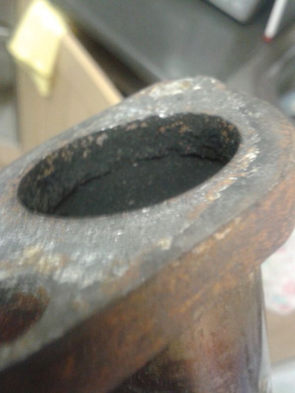

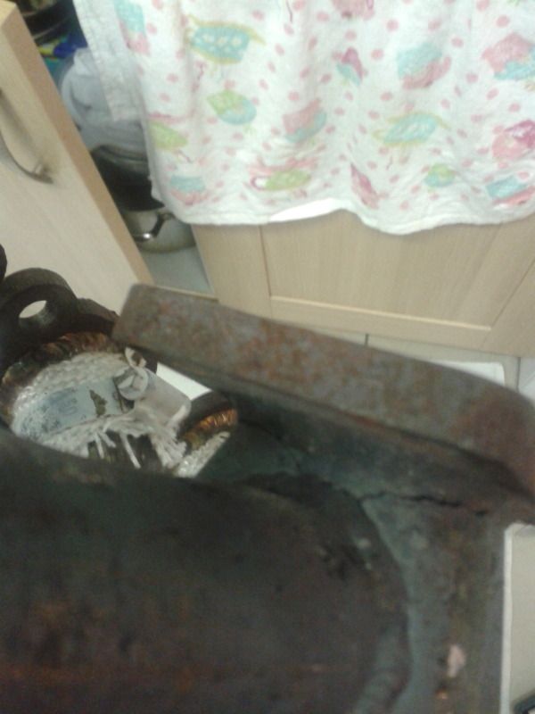

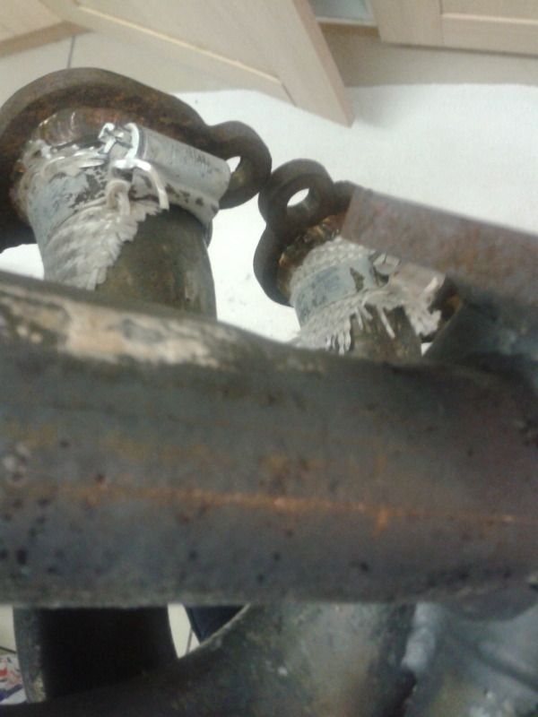

The DP mainfold has cracks and seems damaged and brittle.
They seller does not want to refund me.
I was not told about this before hand.:roll:
Anyway my question is.
Does anyone have experence of dealing with a cracked mainfold?
Are they easy to re weld?
Pictures.
P.s I am yet to take the heat wrap off to reveal the full horrors:)
just get it welded by a competent welder, thats only a minor crack and easy to do. then when you fit it make sure you brace the manifold/turbo properley and the exhaust has to be hung to make sure it puts no weight on the turbo.

Thanks for the advise on how to fix it.

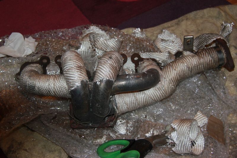

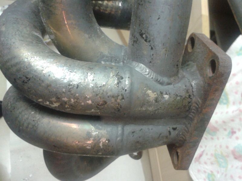

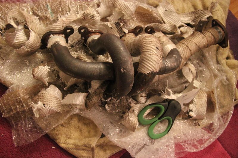

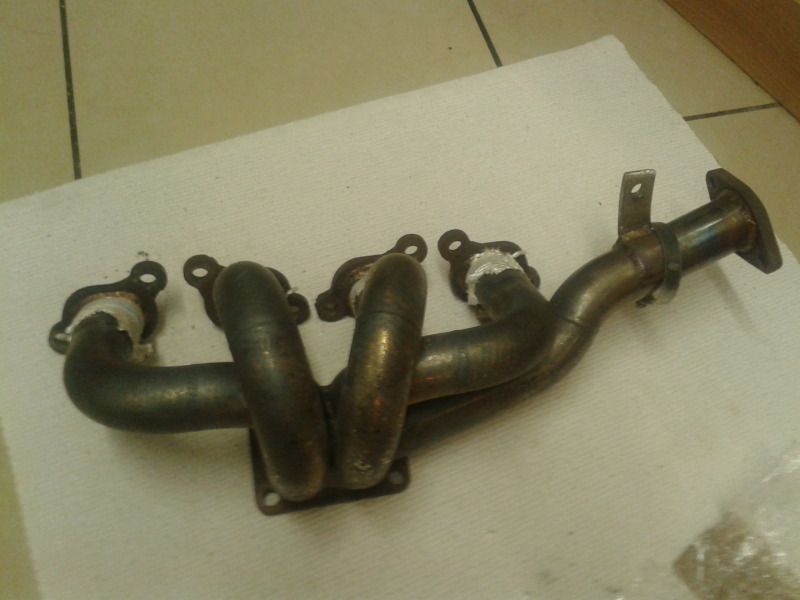

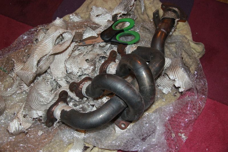

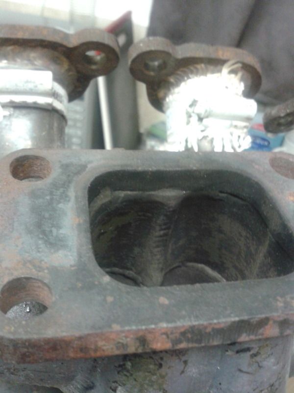

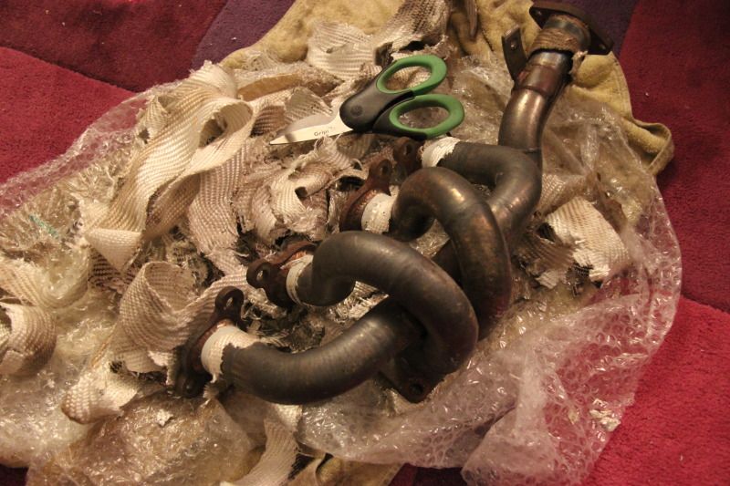

Anyway removed the rest of the heat wrap.
Think it's fixable anyway.
Re weld and creamic coated?
warpspeed
those cracks are just the way it goes when a tubular manifold isn't braced properly.
The problem is you want the steel as thin as possible to avoid heat transfer that you get with thicker steel, but unfortunately this cracks more so the manifold needs braced correctly, that's not as easy as it is to say as you need to know how the manifold is going to expand/contract.
Not much help to you I know but you do need to accept that with the design/build of the manifold you have the cracks are the fault of the original builder and not the person selling it, you could get it welded and heat wrapped and it most likely will have cracked after it's first heat cycle fitted to your car.
