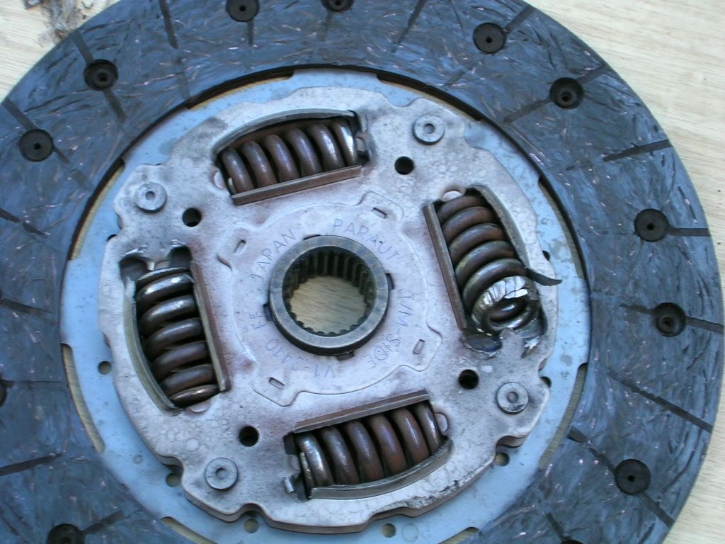

daz
basically this had happened to the clutch plate never made any noise or rattles just got increasingly difficult to select any gears at all apart from when stationary and even then it was a fight.

daz
hehehe lol he pm'ed me and it turned out to be his release fork that was bent :shock: :lol: 8)
