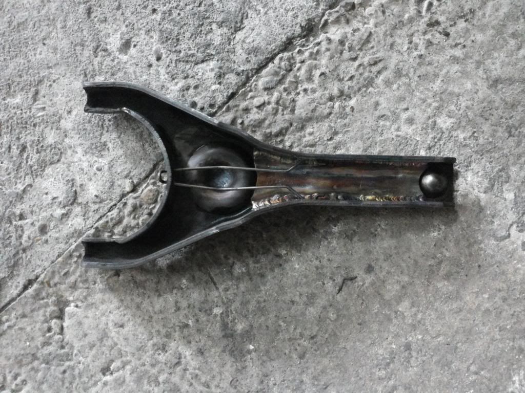

Just some ''boredom'' around the shop.....:)))

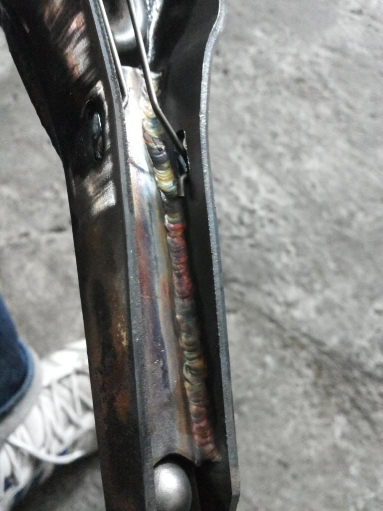

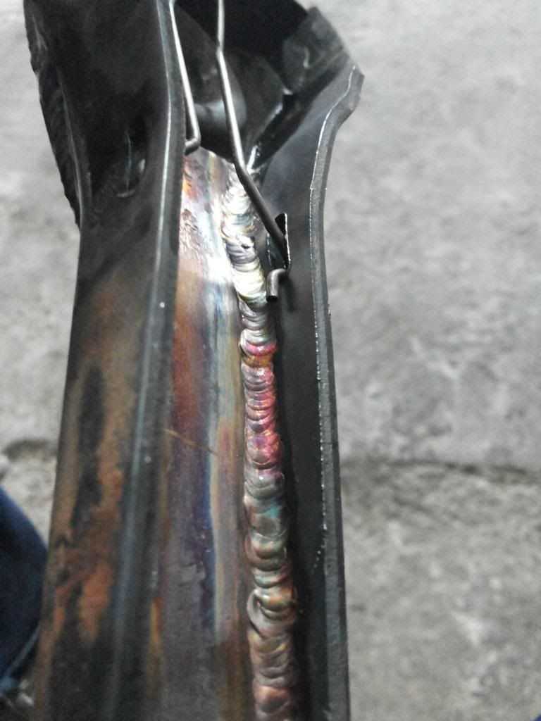

campbellju Moderators Staff member Apr 30, 2014 #2 Nice job. I must break out the welder before mine goes back in. I doubt my efforts will be as neat!
Fusion Ed Active Member May 1, 2014 #4 Just to warn you, it may not go down towards the slave cylinder far enough. I have had them break further back than that...
vss irvine Well-Known Member May 2, 2014 #5 You need to brace the shank of them aswell. And i would just check your clearance as youve added a fair thickness of material to the front of it. nice welding btw.
R RO_SUNNY Active Member May 5, 2014 #6 Thanks Martyn..... Can you ...or somebody post a picture or a link on what else I need to do? Thanks, B
campbellju Moderators Staff member May 7, 2014 #8 Looks good to me but I'm just a fan of your welding ;-)
vpulsar Well-Known Member May 7, 2014 #10 Nice job mate lovely welding skills, I don't think you're going to break that one in a hurry lol. Rob
