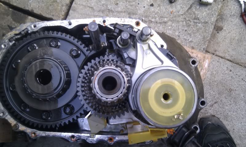

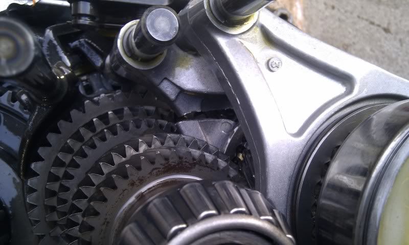

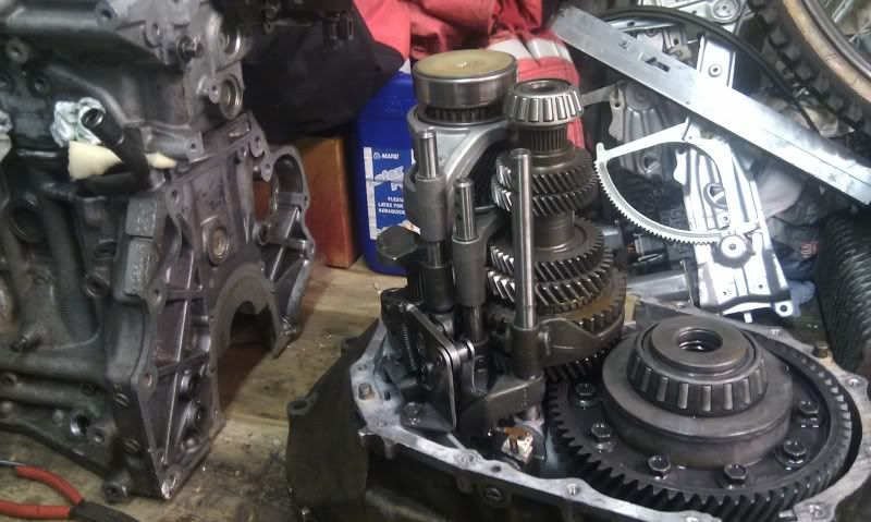

I was bored today so decided to take the box off and check the damage. The selector fork for 3rd/4th gear had snapped and one of the brass syncro rings was slightly damaged so nothing major 8)

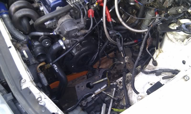

Thought i'd try taking the box off with the engine in too, some bits are a bit fiddly but its definatly less hassle than dropping the engine.

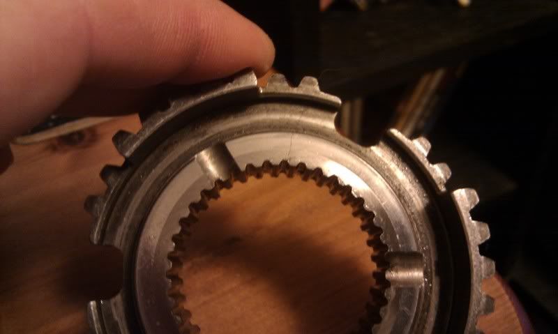

Just built my gearbox back up and found the reason for my snapped selector fork. The 3rd/4th gear syncro hub had a hairline crack in it so it had expanded slightly on the shaft which was making the operation of the coupling sleeve which sits on the selector fork tight.

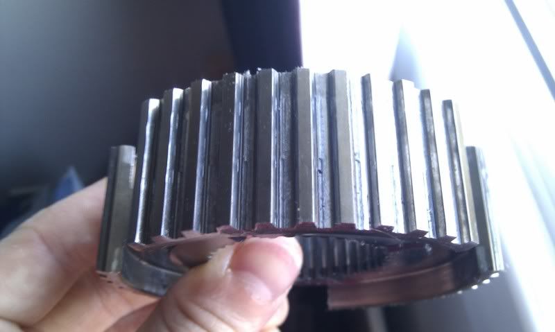

Whilst i had it in bits i checked everything over and ended up changing the syncro hub & coupling sleeve on 1st/2nd too which was also starting to crack and the coupling sleeve had scored the outside of it, 1st/3rd/5th baulk rings had seen better days so they got changed too. I think being repeatedly smashed into 1st gear whilst moving had a lot to do with some of that damage so hopefully it'll change smoother now.
3rd/4th syncro hub, you can see the crack at 12 o clock

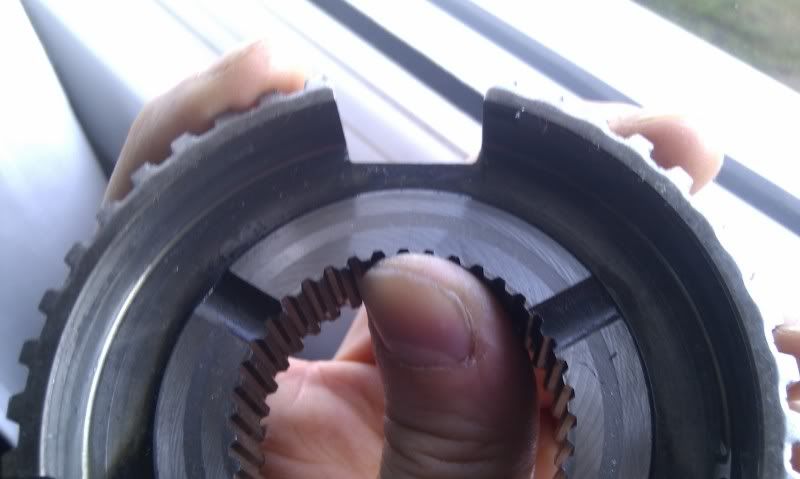

I remember at the previous even at Wiscombe hillclimb 3rd and 4th gear went stiff for a bit then freed up again so that must have been when it cracked. This is the 1st/2nd gear syncro hub.
Another hairline crack (not quite right through)
And the deep scoring on the outside of the same hub, not sure what caused this :?
