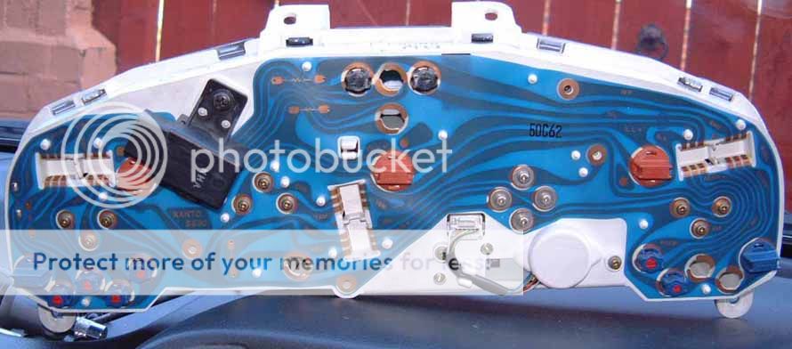

I take it your speedo isn't working? (like mine :? ) Is it a Pulsar? Take it for a thrash and see it the speed limiter cuts in, mine seems to now, so I think I have a knackered delimiter.

had this problem too mate. found it to be the muppets who fitted the speed converter ( which on mine was located next to the relay/fusebox thing on the drivers side inner wing) has not even been soldered in ! just wrapped a bit of tape around and left it.
Soldered it back up and bobs your uncle.
U might have to take out your clocks as some cinverters are soldered on the back of the clocks.

Where's the delimiter ? I take it you don't mean the kmh converter i've taken that off and it started working but only for a few minutes at a time.
Yes it's a Pulsar, my delimiter is bolted to the back of the instrument pack, at least I assume that's the black thingywotsit stuck on there.
You can get separate delimiters and convertors or combined ones as far as I know.
