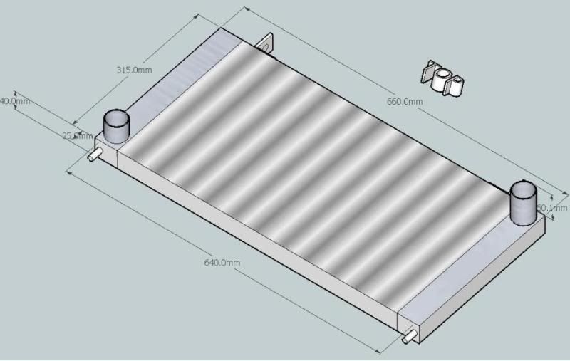

On a serious note, you will need to check your gaps between the turbo and radiator and allow for fans and movement in the engine when underload otherwise it will put large holes in your Rad or just wont fit if the radiator if too thick.

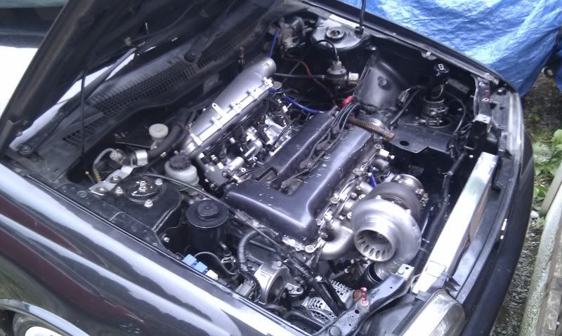

gtir350
True,
Yep, Ive ran this top mount setup before, just on a ebay top mount manifold, now swapping to cast.
I designed the rad to sit in the in the air con location,

WTF are you on about spin the turbo backwards?
Come on chaps, you're smarter than this(some of you :p), it was a joke.
BTW can that v-band cli n the turbine be rotated cos thats a hole in your rad waiting to happen?
That's why it has to face the other way, so that you counter-act it spinning backwards!
