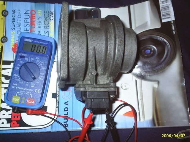

ok fella...as per my pm:lol: we have pins B, C and D thats left to right:-D and what unit do i measure the resistance with?
i can do DCV, ACV, DCA, OHM AND BATT 9V... i' ll assume smallest unit of measurement.
sorry mate its dark and iv just got home from work:oops:
iv got two standard mafs...i' ll post both the buggers to you if needed:lol:
sorry to mess you around but i could only get a reading with DCV @ 200m and 200 ohm' s and its not in the slightest bit consistent either:oops:

From what I can remember Stu, there is a white, orange and orange/blue wire. I need the resistance measured between the white and the orange wires ( Ohms range on the meter ). As above, I'm not sure what letters they correspond to on the connector but I'm sure the white one ( earth ) is the centre one so that will be 'C' ?

Ross: 03.8 on one maf and 03.9 on the other, measured using the 200k unit thingy. if you had said ohms in the first place:D and yup you guessed it im not trained in the black arts of the multimeter:cry: at least i bothered to try and help you out....you' ll get to drive my R before you get to shag my missus btw :D:D:D
TonyTurbo: a=90mm, b=100mm and c 'inlet'=about 78mm
the outlet of a standard maf(opposite side) is 60mm;-)
HOPE this helps lol
