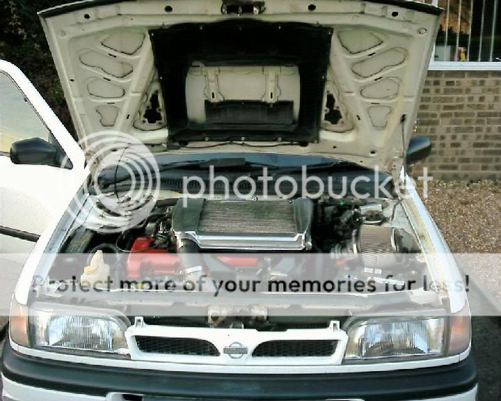

If you look in this pic of my engine bay the boost solenoid is the little gold coloured cylinder on the front of the engine just below the intercooler and to the right of the oil separator :wink:
nitrosgti-r
yes i see it and i had that on the other one but i dont think i have one on me new one?? Er where could he have put it? Would it run with out one? How could i track it down, ie pipes etc?
I dont know how yours is set up, but it will run ok without it :wink:
