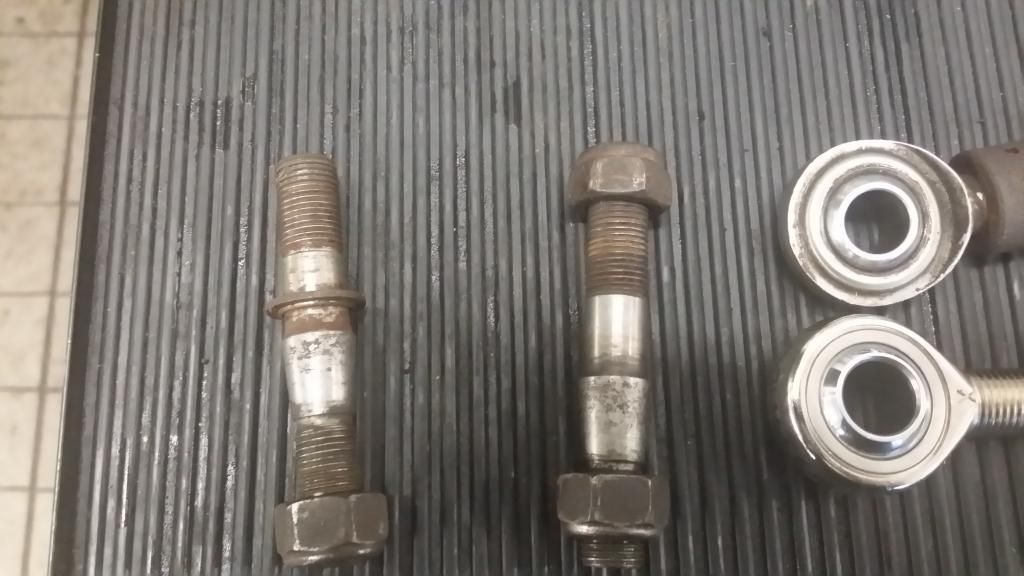

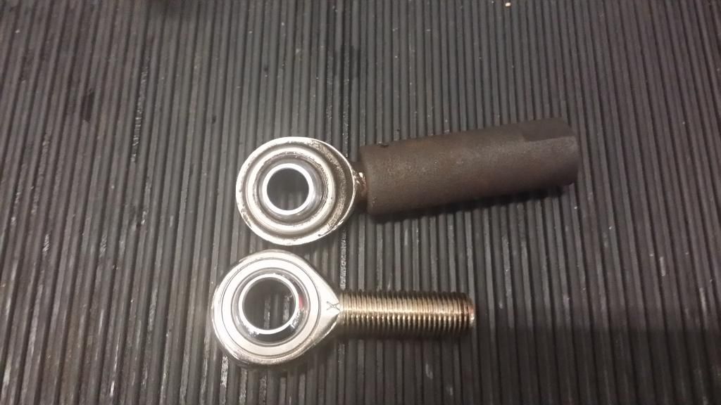

Just got the old one off which i think i bought from powerstation originally. there is a difference in the internal bearing diameter old one are 12.4mm and the above come with 13.4mm and when you slide them over on the old kit there is a gap between bearing and the stud.
Anyone have set of studs/ends which will accomdate the wider bearing kit? was thinking maybe use a sleeve of some sort but don't wanna bodge it.
