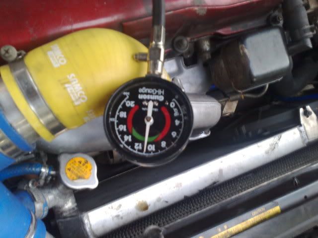

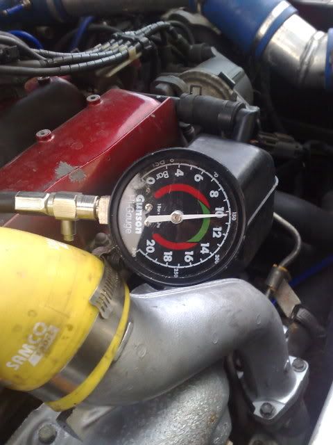

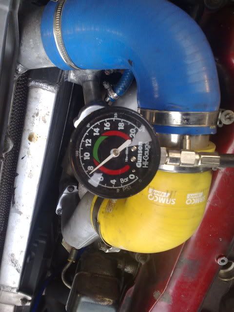

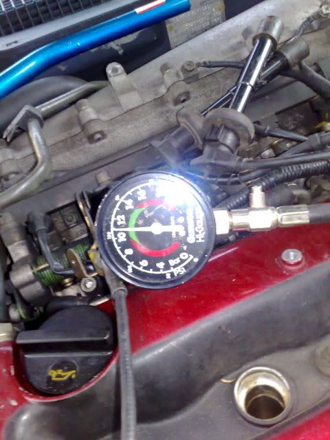

Hi all. well all was going swimmingly and i have been enjoying Pulsar ownership for over a year now but as the title may suggest, today my car puffed it's first cloud of blue. Having had a car do this to me before i knew it could be one of 3 things- valve stems, turbo or rings. Well heres the compression test results and i guess they speak for themselfs;
cylinder 1-
cylinder 2-
cylinder 3-
cylinder 4-
So as you can see i have low comp on cylinder 1. Bugger. Now my car is booked in with Boby next month for a clutch change so the engine will be coming out BUT i can't really afford the kind of work we're talking here on this short notice. I am contemplating a couple of things, non of which involve breaking-

ok so with the above opinions; is it definately rings/piston or could it be something else.
Before i spend lots....
oap-r
I love Rob xxx
Nobody will be able to give you a definitive answer without at least doing some dismantling

engine was hot as i'd jsut driven home, i'd taken the relevant spark plug out but not all and the throttle was wide open. I'd of thought that all spark plugs wouldn't need to be removed as the cylinders are separate from each other?
Azboy, are you able to suply specifications?
take all the plugs out and re test it,with the other three plugs in you can get false reading's,
and normally if your rings are fooked the car will smoke and use oil
