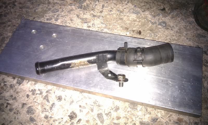

You have forged pistons and big ring gaps, unless the engine is pushed hard constantly on the track it will use oil, all ball bearing turbos supplied in the uk now have the oil restrictors fitted, your car is burning oil because you built a loose engine and under vacuem on over run it is pulling oil past the piston rings then when you use the throttle it is burning it off it is advisable to fit a inline filter to the turbo though. And put that black pipe back in place or you will chuck oil out of the crankcase, the breather system on our cars is fine even with big bore stroked engines nme actually block the crankcase breather and just use the rocker cover ones. And there should be no vacuum in the pre turbo inlet pipe other wise you are massively restricting your car the breather to the inlet is just to burn off gases in the crankcase not create a vacuum in the crankcase.
As I found out the hard way :oops:
Jambo, there is a small restrictor in it and without it fitted like Danny said you'll just keep chucking oil up into the breather system/catchtank.
Thanks for the help guys, I have just been out and put the breathers back as normal. The only difference now is I have larger pipes and a catch tank between rh rocker breather and turbo intake pipe.
