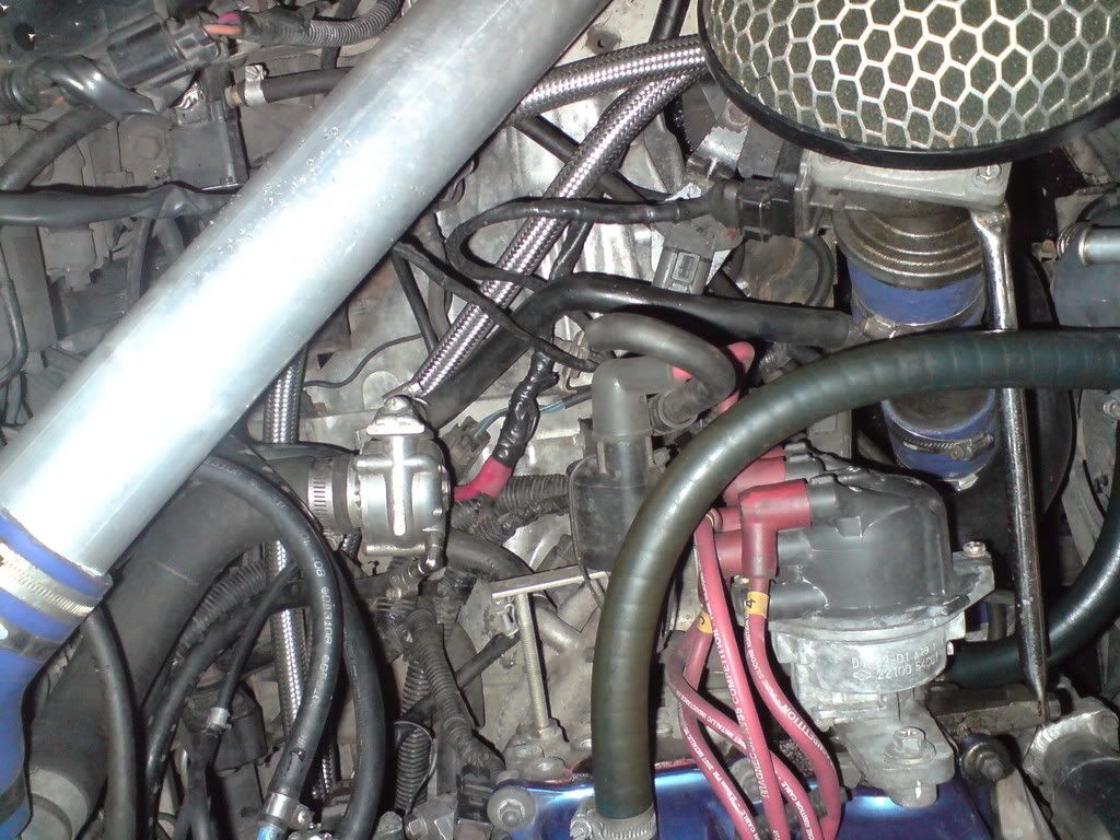

I've had this problem for a little while now but just learnt to live with it. Basically after accelerating and reaching full boost, depending on the speed that i let the throttle back off some times the boost flutters (hard to explain). If i let it off quickly or really slowly theres no problem, but if i let it off at a sort of medium pace this fluttering / surge occurs.
Doing a search through previous posts it sounds like it could be surge, what would cause this ? the way that my bov is plumbed in ?

just means there is not enough vacuum to open your bov, so the air surges over your compressor blades making the fluttering noise. or you may have an adjustable bov and its adjusted very hard.
or
the bov may operate but not a high noise level because of the low boost pressure contained in the piping, ( light throttle) so therefor you will here the surge rather than the bov wooooossh.
you will always get some degree of surge but a bov is there to limit it. when you snap the throttle shut on full boost the air races out the bov with a loud hiss or woosh therefor you probably wont here the surge.
just my thoughts on it anyway.

It's not really the noise that im bothered about, you can actually feel the car sort of jerking as the boost level is fluttering about, feels a bit harsh, worried about damaging the turbo ?

What kind of BOV have you?
How have you installed it?
Best thing is to post a few pics of it installed and / or compare them to others install.
Try adjusting the BOV so its on its slackest rating see what that does if anything.

your turbo should be fine imo. my car does this also at motorway speeds when cruising on light throttle.and as youngy has said, my drivers side engine mount has gone.
some people run withbovs fully tightened down, or even without, so they only get surge. dont wrry about it. just enjoy the noise

I get this also, and have been told it is when you hear the flutter its the air coming back though the turbo the wrong way and sometimes it makes it as far as the maf and interfears with it causing the car to jerk about a little bit.

I don't think you'll find it's anything to do with the bov (what bov have you got ?) it sounds like turbo surge to me, basically your internal wastegate can't flow enough air.

I assume the flutter your talking about doesn't happen on boost, the flutter off boost is more than likely air coming back out, "reversion" this can happen if your inlet is to sort and your MAF is to close to the comp inlet. My Z32 was attached to a 3" 70 degree pipe which was only about 12" long, I used to get reversion when I pulled up to stop, the revs would dip to almost stalling then pick up after a few seconds. I extended the 3" inlet pipe another 6" - 8" away so the filter is righ into the corner behind he headlight and the reversion stopped ;-)

It's a sard bov, it was already fitted to the car when i got it. Its just the last pulsar i had never done this. I'll get some photo's later on.
Also my intake pipework is also pretty short.

My car does the same thing, fluttering. I still have the stock dump valve on, just a larger pipe run, I'd assume that the longer pipe run has more air that needs to be let out. Not really worried, should I be?

Sounds more like what Steve has highlighted as your piperun is very short from the turbo to MAF, may be worth lengthening this and see if that helps any.
