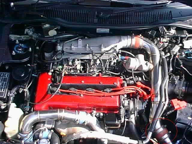

Riiiiiight, Intercooler is fitted, but I am getting more or less no boost.
Basically the scenario lies behind the fact that I don't have a very good connection on the two pipes circled below..
(Pic nicked from gallery)
The bit circled there is air getting out as I don't have the correct silocin hose. Would this cause no boost though?

yeah - it will be pissing out, i'd get it all connected up and tightened (make sure the clips are real tight mate as they will slide up the hose) then recheck with a good blast locally - take some tools with you as well :)
how on earth did you end up with the wrong hose?
gtir bean
air getting out is like trying to blow u[p a baloon with a hole in it so yes if there is air escaping it will lose boost pressure or take longer to gain pressure.

The kit came with 4 hoses, 2 correct, 2 that were wrong bloody size.
And of course everywhere is closed tomorrow so won't be able to get any then, even the friggan jubilee clips i got were crap.
Oh well, least it's all fitted

Yes blue pipes, well the 2 hoses were ok, but the other 2 started correct size but then went to a bigger size...
yeah they step up to fit your intercooler, well mines fitted ok

My cooler pipes were same diameter as the pipes them selves
Damn them
Andybtsn
I used the 2 hoses that were correct for the cooler.
I need other two to correctly fit the pipes on the left and right.
I need to find somewhere tomorrow that sells some, fat chance like on bank holiday
