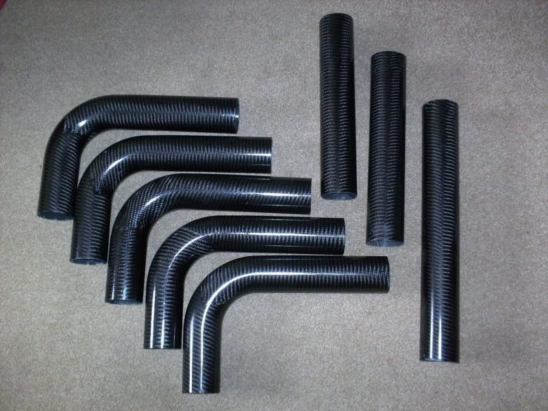

If worried about weight, I've seen carbon fibre used before, great thermal properties too........ but if not worried about weight the weirdest I've seen was soldered copper tube and bends
Greygtir
The only thing that carbon woll do is lighten my wallet. Even with my skills i would have to get a cnc billet mould mahined up then an inflatble bladder made. Loverly if u have the cash but not feasble on my build.
Carbon fibre is a nifty suggestion; if for no other reason that you can have the bends and fittings exactly where you want them. - What about fibreglass as the next-closest thing?
