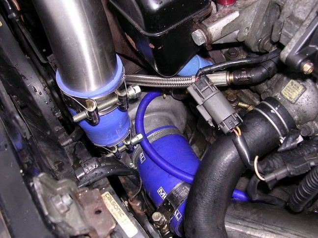

hi mate if you have no luck, try CP fastenings in marmion rd southsea they should have some decent size jubilee clips, or you could always get some decent mikalor clips,
like these:
There a couple of quid each but they will never budge! :wink:

They look the daddys. I'm gonna get them. Anyone know what size they are?

The problem you have is because on the pipes you have there are no little 'bits' of metal for the clamps to hold onto. I know it's not a very good way of explaining it so i'll try and find a pic of what i mean.

yes, as my intcooler pipes have them on and i use to run 1.2 bar of boost with standard jubliee clips all day long.
Somthing as simple as this would solve your problem. You only need big Mikula (sp) clips if your running big boost.

I didnt have a lip on my pipes, and they kept blowing. i used a pipe flaring tool at work, and its stopped the problem :wink:

What I found is that it was fine up until things got hot, then it would always be the pipe run on the hot side of the intercooler that suffered.
I took all the pipe run off and ran a weld all the way round the end of each pipe, about a 1/4" from the end. Never happened again.
I got Mikolor clips now as well so the f00kers will never blow off.
