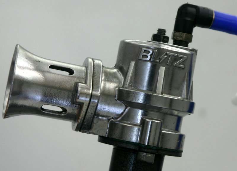

I've got one of these on mine, and it's the best dumping BOV I know! Mines a combination of the older one (with the Pingu "beak" on it) and the body of the newer one (with the "snout" on it). Mines got the Pingu end on it as shown above.
They are adjustable, so wind it up and get ready for a sonic boom! :twisted: :D

cool :thumbsup: , what do you use to get the bov to fit the boost pipe as the pipe is pretty big?
