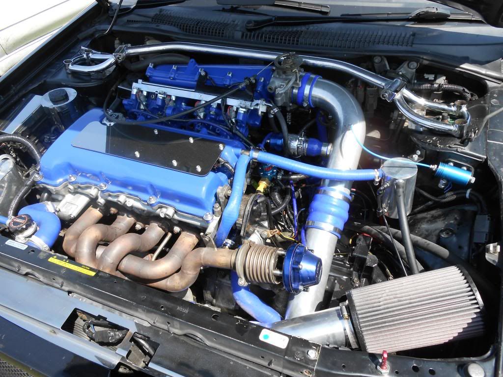

Then the bad news, I looked into my mirror to see loads of smoke out of the back window. I immediately pulled over and turned the engine off and was towed off the track.
Ed and Dan (red reading) took a good look at the car to diagnose the problem. They both feared the worst with a rod coming out of the side of the block. Upon further inspection, the engine had blown the oil seal so after a bit of cleaning, Ed put the filter back on and started her up. Everything seemed fine with no knocks or smoke so I think I was very lucky.
Drove the car back home and no problems so hopefully everything is ok and I managed to switch the engine off without causing serious damage. Time will tell but keep fingers crossed.

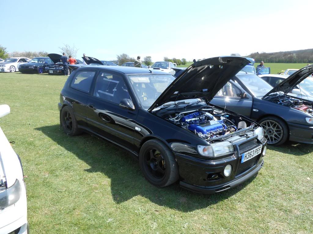

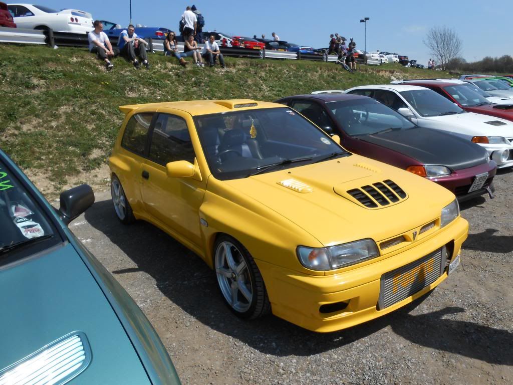

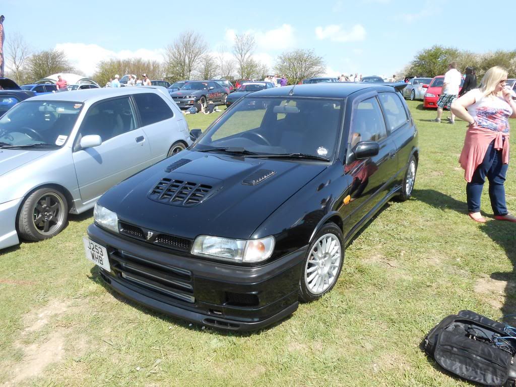

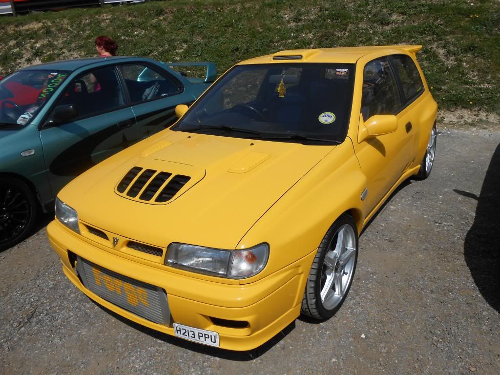

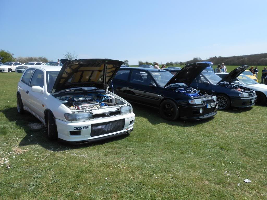

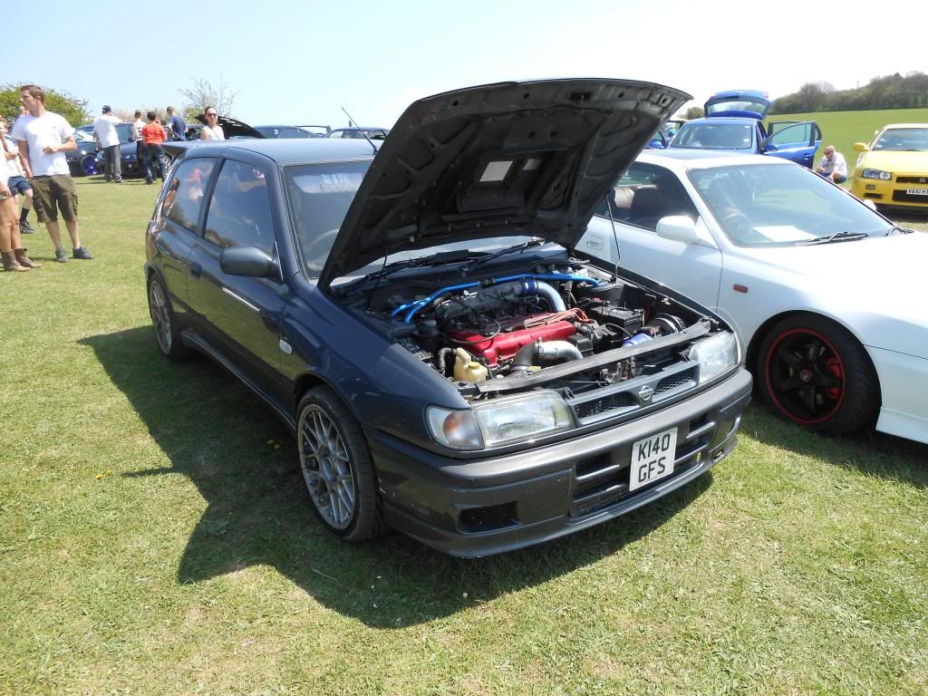

Some piccies
Big thanks to Ed and Will at Fusion for organising the event and to Dan (red reading) for his input and advice.

It's not the first time I've heard of that on a gtir. Do you know what caused it? Filter coming loose, high oil pressure, faulty seal?
Fusion Ed
Old soft seal by the looks of it. Sustained high RPM, which the car has never had before 90psi etc has pushed out the seal. Again not the first time I've seen this. They need some kind of reinforcement in them, they are quite poor really. If the plate was machined in a different way to allow a thinner seal to fit then it would be fine. Horrid things. The biggest problem is the aluminium thread that the pulsar has on the oil housing. If it was steel you could clamp it up, but if you do they risk snapping - which I have seen also happen.
