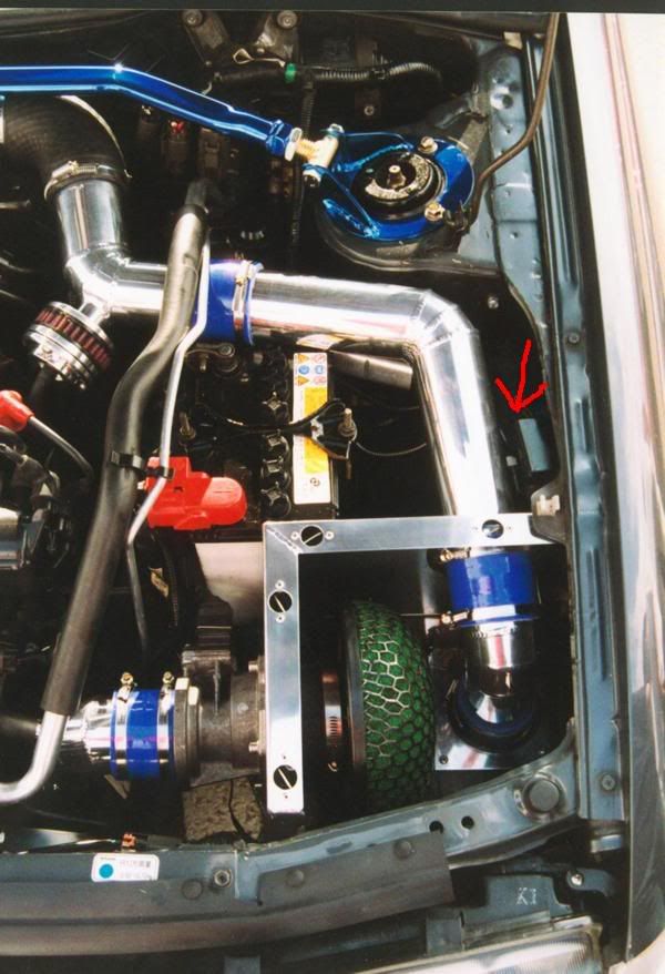

i T'd into this vaccum pipe for a reading. pipe comes out just underneath the small black box with arrow pointing to it.
hope it helps

That's where the OE boost guage measures from and where I have plumbed in my Autometer boost guage.
That's still along way from the plenum though, I was thinking of somewhere a bit closer ?!

think i u follow the pipe back it t's off and goes up to the fuel presure regulator could t it off from there
That's where it's T'd off now, where Apexi recommend to take the reading from :!:
I'll explain my reservations as that might help. Basically, the pressure sensor is currently T'd into the same pipe as the FPR, as Apexi recommend. However, I have been having boost spikes and so investigated a bit. The AVC-R is currently set to 1.00 kg/cm but, spikes as high as 1.20 kg/cm. It appears that the boost pressure spikes, when I lift off the gas to change gear which, strikes me as a bit strange as the turbo will no longer be loaded up then, and so should not be making boost ?! This leads me to believe that the source where the pressure sensor is taking it's reading, is not very accurate. And this is why I want a vacumn take off that is more accurate and reliable than the current one, preferably as close to the plenum as possible and with nothing else T'd into it !
