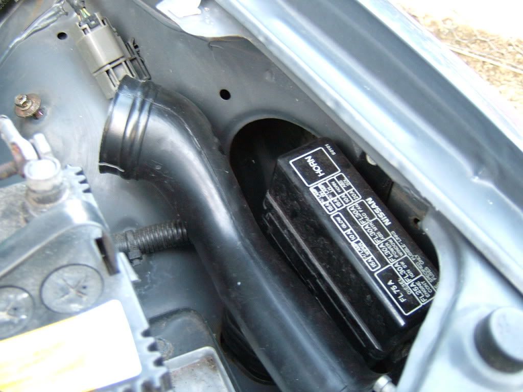

i take it your battery is under the bonnet. you should be able to push it though the rubber gromet where the loom comes tho

the one in mine had the cable going from battery to pasenger wing then down the door trim and under the kick plate thing where the rest of the wires run to the back of the car
SunOnGTiR
I'm thinking about that as well....whatabout where the cable meets the door shut?

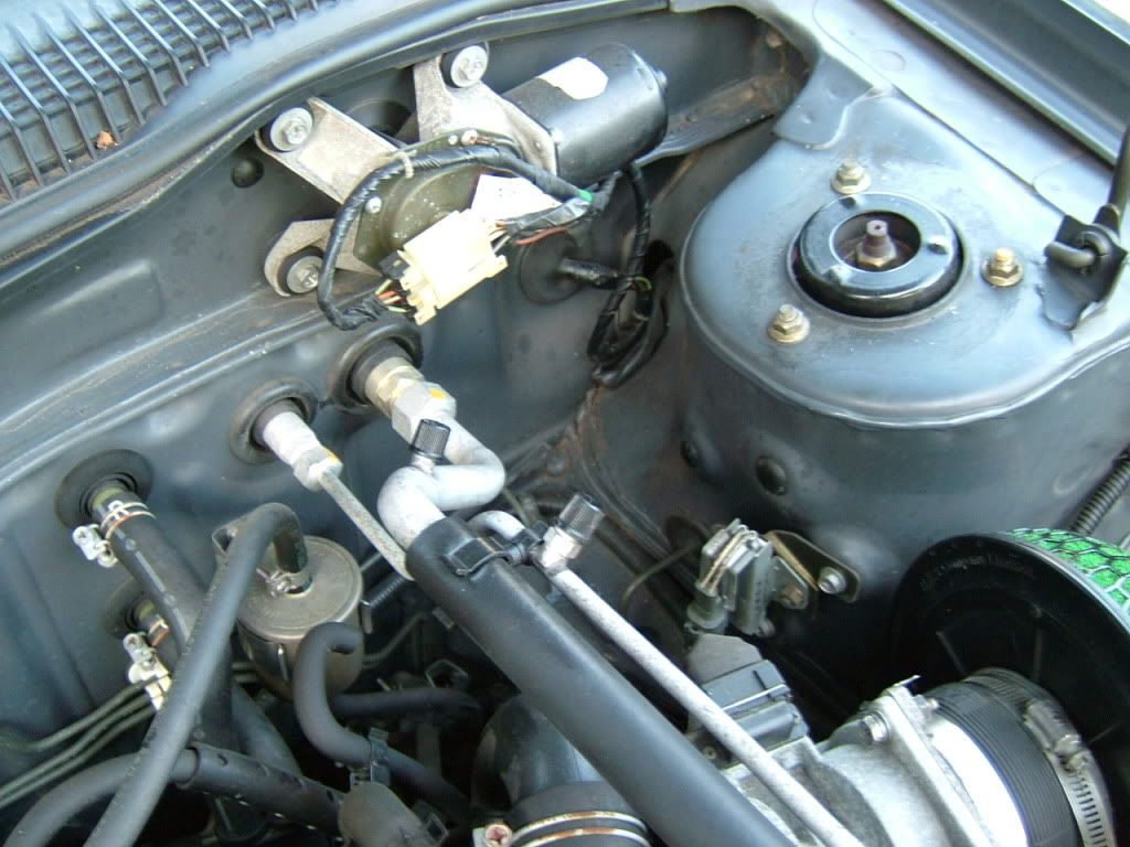

Don't know how to photoshop....but feel free poke the holes for me:lol:

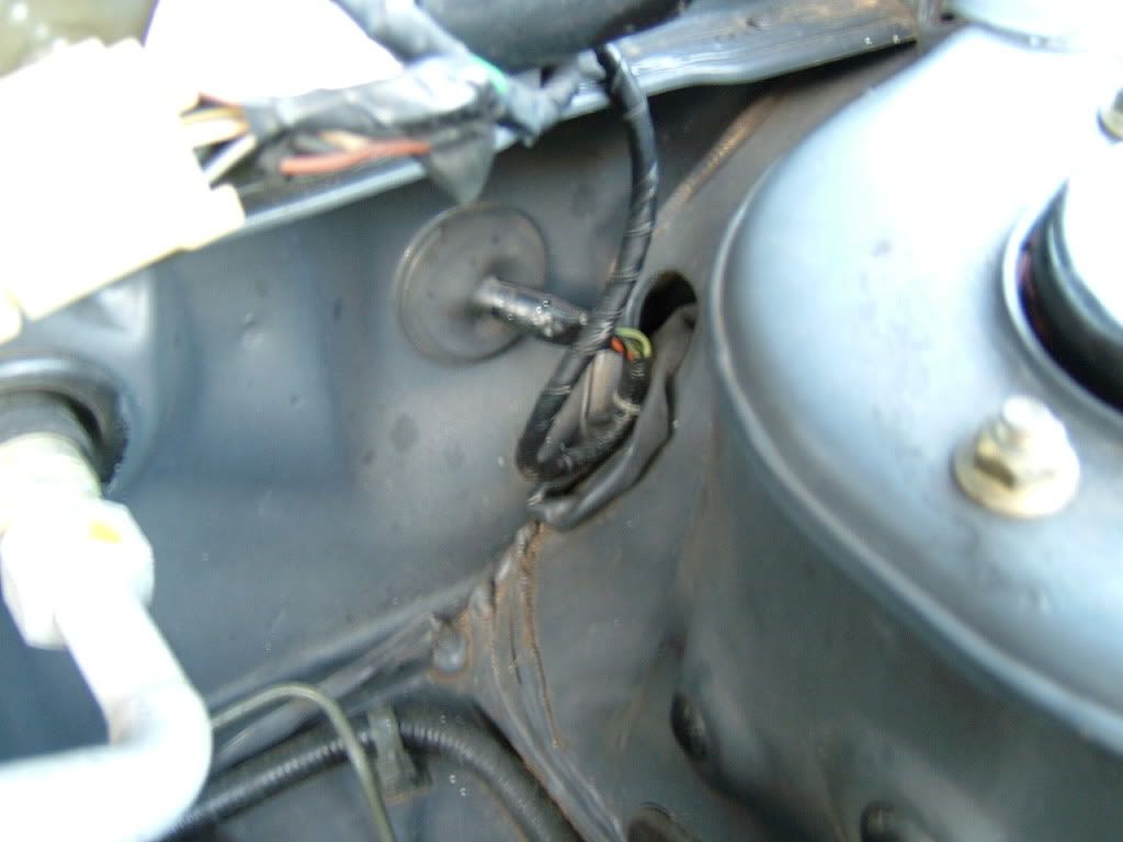

Is the wires wrapped in tape the loom?
Another hole area.I'm thinking of here....
This is the area the majority would put the power through,yes?
