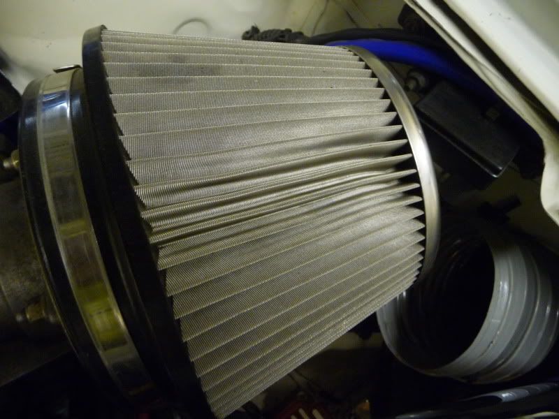

I will proberly be changing to k&n at some point as i am running a blitz sus atm,you only have to look through the blitz to tell it aint a good filter.
