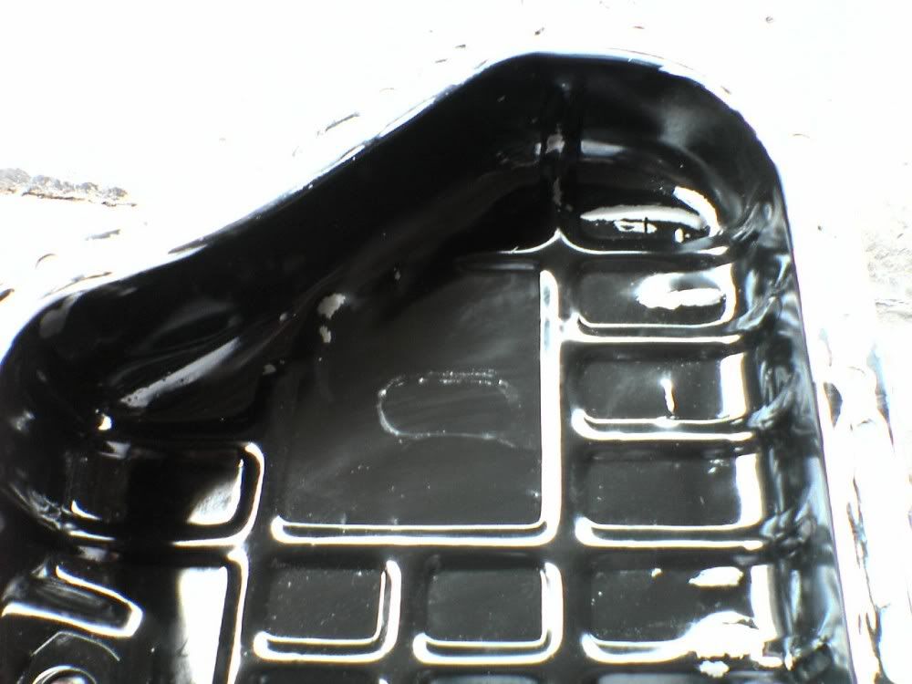

The sump was bent right up against the oil pick up. It was so tight against it that you could see the impression of the oil pick up against the pan:

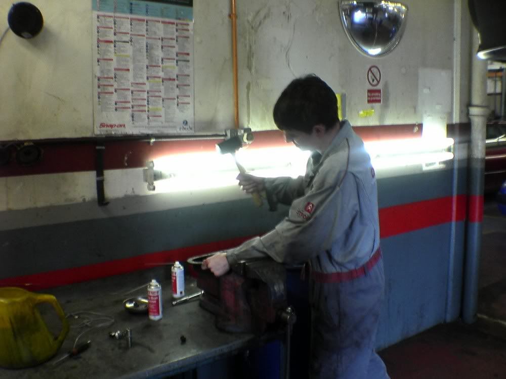

Eeerm, one method of removing the offending sump dents:
As soon as we put it all back together the oil pressure was back to normal.

where is the relief valve posistioned?
In that picture you can just see the large bolt top of the oil pressure relief valve right inside the bottom left of the sump.
I think you can only get it out with the Ali tray part of the sump off though.
