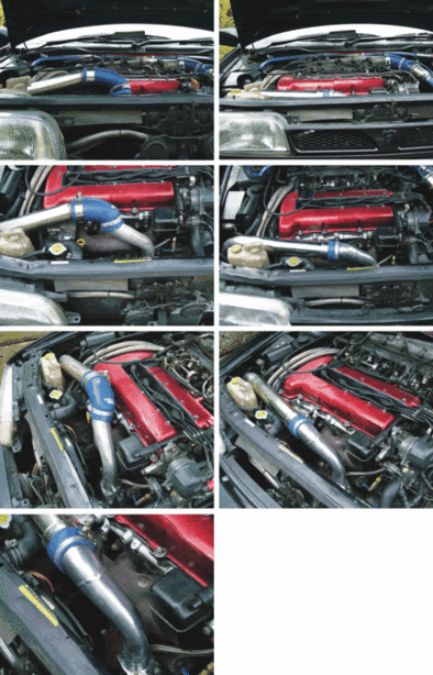

Well, as some of you know I now have a forged piston rebuild in the car and it's now run in and going to be mapped on Monday 1st Aug. As it's booked in I thought I would take the time to sort the bits I rushed before, namely bits of the pipe run. The main thing that needed sorting out was that I was still using the original Ali turbo compressor elbow and as you can see from the picture below was less than perfect, on close examination you can see how it really strangles the pipe. Anyway I thought I'd have a go at modifying a spare Ali elbow I had. I measured up what I needed and cut the elbow in a couple of places, turned things about a bit then welded it back up and polished the inside. I also made up a new stainless section of pipe run to join up to it as well whilst I was at it. There's a few before and after shots below so you can see how I have changed it.
The change to the way the car drives is amazing although I can't test it properly (as it's not mapped) the turbo spools up about 700 rpm faster, on about 1/3rd throttle I hit 1 bar by about 2900 rpm.
BEFORE......................................AFTER
