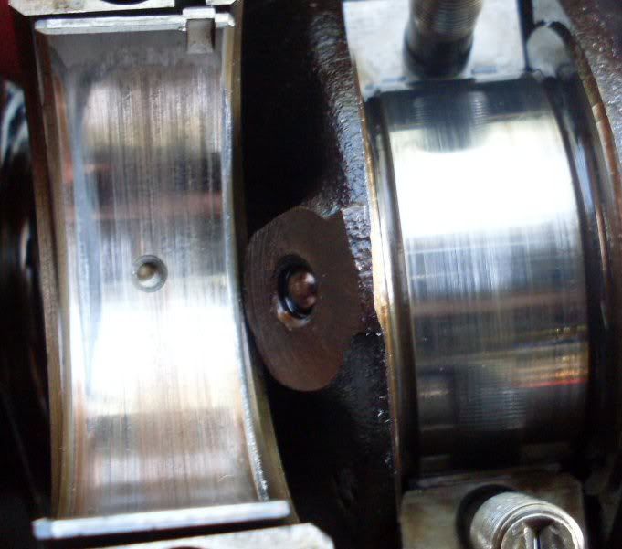

at last i have all my bearings ready to finish my rebuild but i don't trust the last person who built my engine and want to confirm the positions of the bearing caps.
on my car the old bearings were installed correctly on the upper sides as the conrods and block dictate which way round the bearing goes. so the little lock tab sits in the groove and can only go in one way.
the caps also have this groove for the other half of the bearing but the caps can be turned around. should the little lock tabs both be at the same side of the bearing or should the top one be on the opposite side?
here is a photo of one of the bearing when they were first removed.
you can see on the cap on the left there is the little tab to locate the bearing. should this be mounted at the same end as the other bearing's tab or should the tabs not be on the same side?
did that make any sense?

You should have numbers stamped on the side of the caps numbering what bore they are for i.e 1,2,3,4 there should be a number on the rod and the cap make sure they are both on the same side,failing that.the locating tabs should be on the same side

i don't think i explained myself very well. one of the downsides to being stupid...
the bearings can only go into the block, rod or caps one way as dictated by the little locating tabs. however the caps can be turned 180* around and i'm not sure which way round they are meant to go.
should both tabs be on one side of the bearing or should the cap have it's tab on the opposite side?
the picture above shows the tab on the cap but not on the conrod. the tab on the conrod is at the top of the picture, should the cap be installed with it's tab also on the top (as shown in photo) or bottom?
thats what murf said lol
make sure the oil jets (on rods) face towards back of engine as ive seen a few put in completely the wrong way round

there are oil jets on the rods? lol i'd best take a closer look at that.
i read what murf said as the bearings fit the race only one way and this can be found from the number or the locating tab. rereading it i see he did say which way round the caps go.
