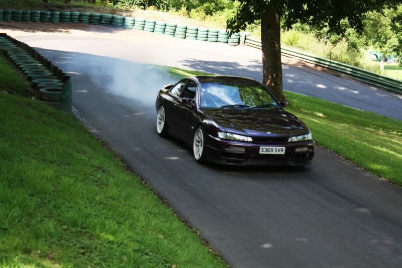

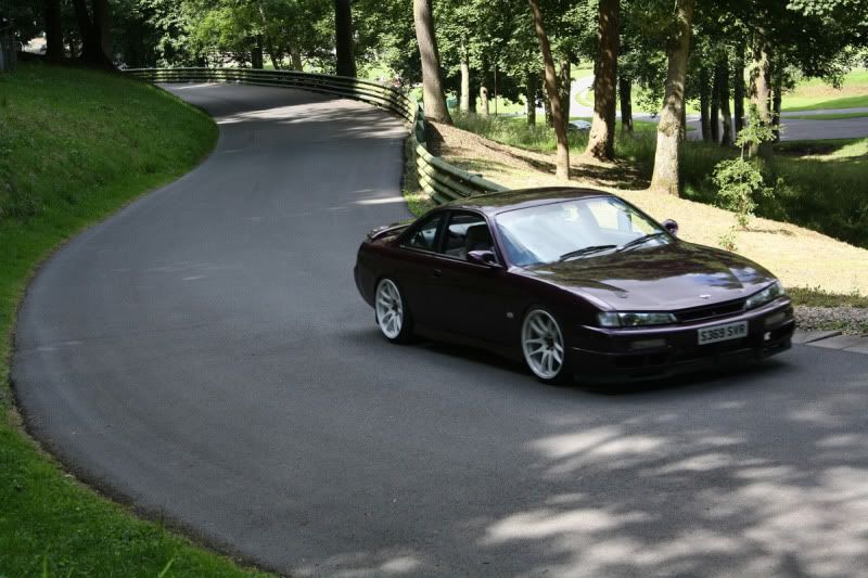

i missed drifting so i bought another s reg 200sx s14a which i have fitted a RB25DET skyline engine and transmission , power im looking for is 450bhp
this is a quick link to 1 page full of photos and vids from start (standard with sr20det) to now
please take just 2 seconds to look :) , i no its a chave site but my proper project thread is 30 pages long on sxoc lol
http://www.sxoc.com/vbb/showthread.php?t=394531
this has same pics but no talking
http://www.skylineowners.com/forum/showthread.php?t=116311
quick spec is
RB25det out of R33
HKS ssq bov
ARC front mount intercooler ( have a bigger one waitin to be fit )
RPS stage 2 clutch rated 450 lb ft
hks plugs
60mm ally rad with twin 12 inch slim line fans
3" DOWN pipe ( no cat )
3" de cat pipe
3" blitz nur speck R exhaust
Blitz induction kit ,
60mm water temp
60mm oil temp
60mm oil pressure
60mm boost
60mm volts
60mm vacuum
Q45 throttle body
greddy inlet plenium ( not fitted yet )
custom prop shaft
suspension
apex gen 2 track coil overs 8/6 spring
32 way dampen adjustable
rebound adjustable
adjustable top mounts
driftworks camber arms
cusco tension rods
set up to white line fast road / track settings
brakes
345mm big brakes ( not fitted yet )
grooved rear discs
wheels
9.5j et 15 front and rear with streched 225 / 40 /18 falken 452 tires
safety / body
6000k HID KIT
clear indicators / side reapters
lockable bonnet catches
2x fire extinguishers
rear rollcage
thanks for looking and comments welcome good or bad:)
