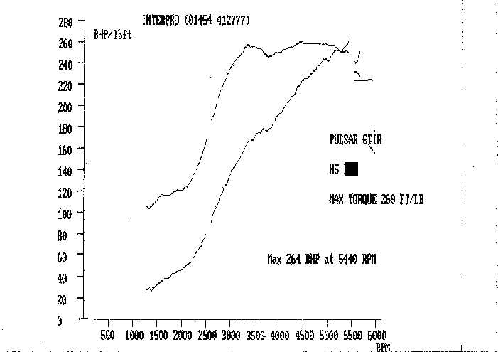

I don't think an uprated ignition system would make that bigger difference, but ignition timing might. I'd be surprised if you don't have uprated cams in there. Do you have a copy of a rolling road printout you could post up for us?

so iam not the only 1 to have promblems with bp fuel ill have a look at the car in a bit as for rollin road i not got it but remember the torge curve shot rite up. the engine inturnals are the same spec as Dp motorsports 10 of the best car that ran a 11.09 1/4 mile. I spent my money havin engine make to take big power i only had the car 8 monthsso still new to it. it does tic over abit on the it not so sure wot its up 2 like so may av a cam.
