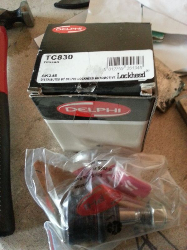

I think they're a press-in, but for the cost of a wishbone with a new balljoint in it I just replace the lot.
Our ball joint are press in with a locking circlip, you can replace them with gti ones but you do need to do a bit of work to fit them.
Mr B
Done mine with ADL or Solid-Ace (can't remember) ball-joints from gti/primera 16v, was straight forward press replacement.
Quality on ADL or Solid-Ace is very good so will last well if fitted right & I doubt rebooting existing ones will be a long term repair
The gtir ball joints are 1mm smaller than the gti/ primera etc, you should take the knurled area down off the aftermarket ones in a set of soft jaws in a lathe or open the wishbone up slightly with a die grinder and sanding disc....then press them in........pressing them straight into the wishbone is not the best idea with out the machining as 1mm is a lot to stress the wishbone with for a tolerance fit.....the ball joints are about a £10 from a motor factors.

No knurling on ones I had. they where made by 555 Japan & sourced from Barum AP from Solid-Ace parts range. Worth checking with a good motor factors as have a feeling ADL & Solid-Ace have specific part number for GTiR .
karl the one you posted up in ebay link will fit fine
the top part is 16mm and bottom is 30mm
