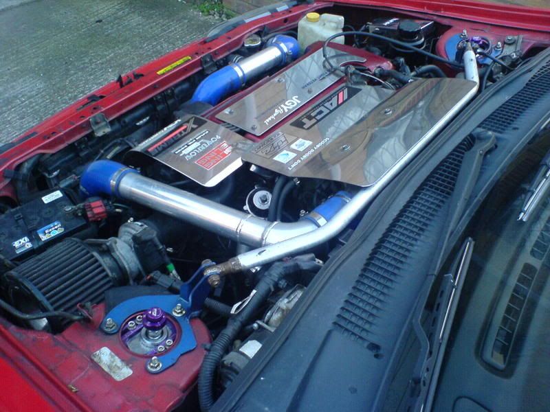

you might not have one (as such) - theres a chance the original recirc is there, RH side of the rocker near the back
ooster
a thought thats where it went , i bought a new baileys d/v and put it on there but it seems not to be making a d/v noise more like a purring noise . any idea what this is.
cheers
andrew
here is where my hks one goes mate off that pipe your talking about...look closer, i had a baileys evo twin piston on my old gtir- it didn't make a psssssh sound more like a wollow flutter.
May check your boost pipes are not loose, or if your running less boost it doesn't always make a loud sound
http://i76.photobucket.com/albums/j11/20legacy/DSC00553.jpg
houghy_1
Heres how my Baileys looks.
Its positioned on the pipe coming off the plenum with a vacuum from the plenum on the top.
I think thats where the original recirc d/v comes off the plenum and into the black plastic original air pipe.
Hope thats a bit more easier to see;-)
