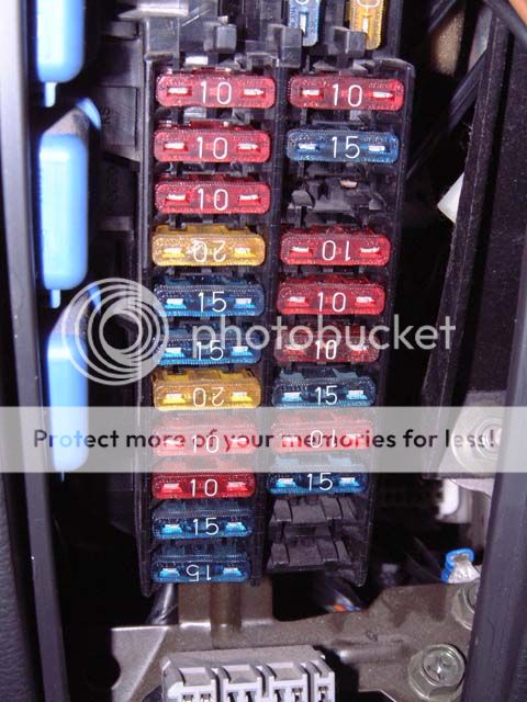

Just had a look in the good book and the accessory relay is the 2nd one down on the left side of the fuse box, top one being the ignition relay.
Just visible as blue items on the side of this picture.

gotoinstant-redline
your a star! now i just need a new one of them :roll:
prolly only a couple of hundred quid from nissan.
err. also, it doesnt look easy to get that out of there! is there a trick to it?

kyepan
yer that bit of the dash comes off pretty easily :) screws at the top of that bit where the steering column meets.
